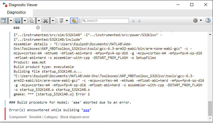

I have the following problem when compile:
Product: aaa.mot Build product type: executable Building file startup_S32K148.o... "C:\Users\Equipo9\Documents\MATLAB\Add-Ons\Toolboxes\NXP_MBDToolbox_S32K1xx\tools\gcc-6.3-arm32-eabi/bin/arm-none-eabi-gcc" -c -mcpu=cortex-m4 -mthumb -mfloat-abi=hard -mfpu=fpv4-sp-d16 -g -mcpu=cortex-m4 -mfpu=fpv4-sp-d16 -mfloat-abi=hard -x assembler-with-cpp -DSTART_FROM_FLASH -o startup_S32K148.o startup_S32K148.s gmake: *** [startup_S32K148.o] Error 1
### Build procedure for model: 'aaa' aborted due to an error.
Error(s) encountered while building "aaa"

Hi ferminzafira@hotmail.com‌,
Can you go inside the aaa_mbd_rtw folder, run the following command in Matlab Command Window, and post the output here:
!"C:\Users\Equipo9\Documents\MATLAB\Add-Ons\Toolboxes\NXP_MBDToolbox_S32K1xx\tools\gcc-6.3-arm32-eabi/bin/arm-none-eabi-gcc" -c -mcpu=cortex-m4 -mthumb -mfloat-abi=hard -mfpu=fpv4-sp-d16 -g -mcpu=cortex-m4 -mfpu=fpv4-sp-d16 -mfloat-abi=hard -x assembler-with-cpp -DSTART_FROM_FLASH -o startup_S32K148.o startup_S32K148.s

ferminzafira
When I runed the command, Matlab retuned:
 !"C:\Users\Equipo9\Documents\MATLAB\Add-Ons\Toolboxes\NXP_MBDToolbox_S32K1xx\tools\gcc-6.3-arm32-eabi\bin/arm-none-eabi-gcc" -c -mcpu=cortex-m4 -mthumb -mfloat-abi=hard -mfpu=fpv4-sp-d16 -g -mcpu=cortex-m4 -mfpu=fpv4-sp-d16 -mfloat-abi=hard -x assembler-with-cpp -DSTART_FROM_FLASH -o startup_S32K148.o startup_S32K148.s
arm-none-eabi-gcc: error: startup_S32K148.s: No such file or directory
arm-none-eabi-gcc: warning: '-x assembler-with-cpp' after last input file has no effect
arm-none-eabi-gcc: fatal error: no input files
compilation terminated.

paulvlase
Did you run that command inside aaa_mbd_rtw folder?
Can you post the output of pwd command, before running the command that command?

ferminzafira
No, I run in "C:\Users\Equipo9\Documents\MATLAB\Add-Ons\Toolboxes\NXP_MBDToolbox_S32K1xx\tools\gcc-6.3-arm32-eabi\bin/arm-none-eabi-gcc" -c -mcpu=cortex-m4 -mthumb -mfloat-abi=hard -mfpu=fpv4-sp-d16 -g -mcpu=cortex-m4 -mfpu=fpv4-sp-d16 -mfloat-abi=hard -x assembler-with-cpp -DSTART_FROM_FLASH -o startup_S32K148.o startup_S32K148.s"
When I run in "C:\Users\Equipo9\Desktop\NXP\aaa_mbd_rtw" Matlab returns nothing.
>> pwd
ans =
    'C:\Users\Equipo9\Desktop\NXP\aaa_mbd_rtw'
