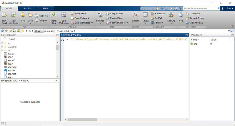

paulvlase
Hi ferminzafira@hotmail.com‌,
Can you go inside the aaa_mbd_rtw folder, run the following command in Matlab Command Window, and post the output here:
!"C:\Users\Equipo9\Documents\MATLAB\Add-Ons\Toolboxes\NXP_MBDToolbox_S32K1xx\tools\gcc-6.3-arm32-eabi/bin/arm-none-eabi-gcc" -c -mcpu=cortex-m4 -mthumb -mfloat-abi=hard -mfpu=fpv4-sp-d16 -g -mcpu=cortex-m4 -mfpu=fpv4-sp-d16 -mfloat-abi=hard -x assembler-with-cpp -DSTART_FROM_FLASH -o startup_S32K148.o startup_S32K148.s
Paul

paulvlase
Did you run that command inside aaa_mbd_rtw folder?
Can you post the output of pwd command, before running the command that command?
Paul

8,458 次查看
constantinrazva
Hello ferminzafira@hotmail.com,
Go to the place where you have installed our toolbox and you'll find this script in the root. You can manually run it, or run it from the terminal (while you are in the root directory of our toolbox).
Kind regards,
Razvan.
