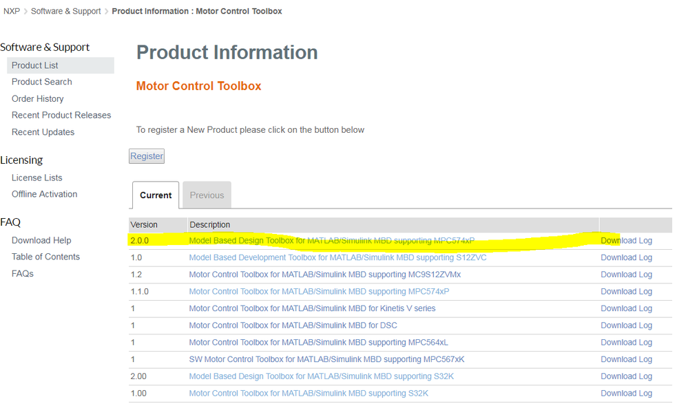

The NXP Model-Based Design Toolbox is free of charge but it still require you to own a license to work.
The license can be downloaded for free your NXP account.
How to get and install the license procedure is shown in this video:  Video Link : 7692 starting with 3'15" (same video is also available on YOUKU)
Short tutorial below:
Step 1: Log in into your NXP's account;
Step 2: Select the MBDT link you wish to generate the license for:
Step 3: Select the License Keys Tab:

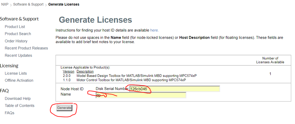

Step 4: Select the available license and click on generate

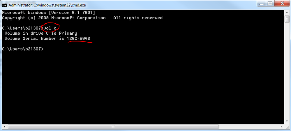

Step 5: Open a CMD and type "vol c"
Step 6: Add the information about your setup and generate the license
Step 7: Generate and save the license on your PC into the ...\mbdtbx_MPC574xP\lic folder
Step 8: Restart MATLAB and have fun!!!

Do you have an A: or B: drive installed?
Do not just navigate to the C: drive.
Navigate to mbdtbx_MPC574xP\tools\mlt
Run  !lmhostid.exe vsn
That is the number you should use to generate your license with.
