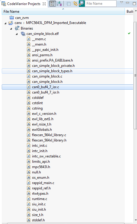

zili
I'm using Motor Control Development Toolbox in Simulink for MPC5643L and trying to download the code into the MCU. For some reason, code downloading by RAppID doesn't work. Thus, I'm trying to create a code warrior project (CodeWarrior 10.7) with the generated code. Should I use the makefile importer wizard in CW or create a CW project and add files? What is the right procedure to do this work? Many thanks.
15,134 Views
raduivan
Hi Zili,
   To be able to download the application using the toolbox you have to flash the rbf file first, please see where to look for MPC564xL.rbf file ?
Regarding the second question you can use CW elf importer to load the executable info and to make a debug session.

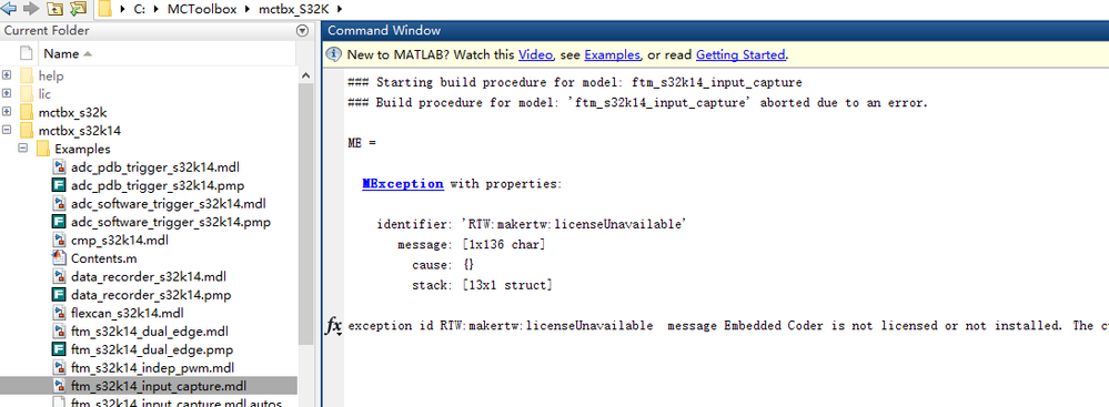

I am using MCToolbox in simulink for S32k144 and trying to generate from the model and download the code into the MCU.
For some reason ,code downloading by RAppID doesn't work . Building the example  model , occur the error in matlab , like this:
I can't find a good way to solve this . what is the right procedue to do this work ? I need you help !!

Hi Feng,
From the error message it looks like you don't have the Toolbox "Embedded Coder" installed or a license for that Toolbox. Can you please type 'ver' in MATLAB command window and send me the output?

fengwang
Hi Radu,
Do it as you like :

exception id RTW:makertw:licenseUnavailable message Embedded Coder is not licensed or not installed. The current target is: C:\MCToolbox\mctbx_S32K\mctbx_s32k14\mctbx_s32k14\mcd_s32k14.tlc >>

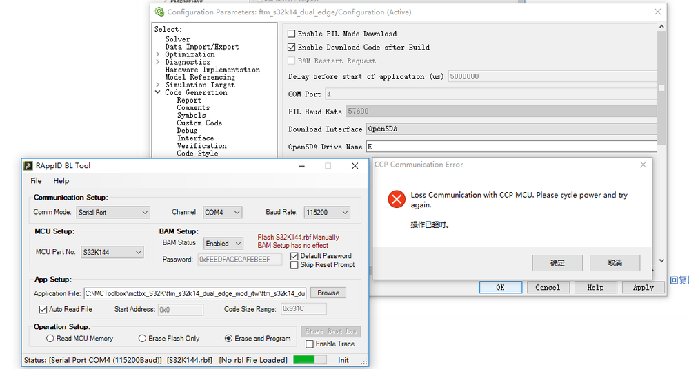

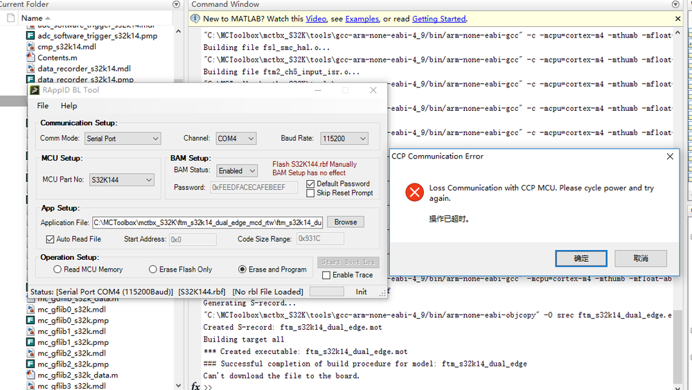

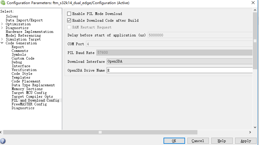

     Thank you do this for me , I find the reassion occur the error . Building  is ok , i find the ".mot". I use the RAppID to download the code into the MCU.
Occur this error :
I need you help again !
Many thanks
Feng

raduivan
Hi Feng,
In order to use the Bootloader you need to write the rbf file but it is an easier way to put the application on the target. Double click on MCD_S32K14x_Config_Information block, select PIL and Download Config and use the OpenSDA interface and set your Drive Name .
Radu

fengwang
Hi Radu,
my model set as you said , but the error is not change ~

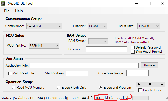

fengwang
Hi Radu,
Why i can't the message about "[No rbl File Loaded ]" in the RAppID BL Tool ?
Feng
14,343 Views
fengwang
Hi Radu,
I can't solve this error , I need you help , please !
Feng

raduivan
Hi Feng,

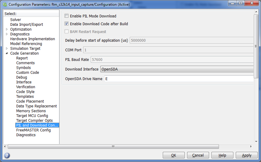

   Please make sure your OpenSDA drive is E: and second the application is automatically moved to the target after build so you will have to rebuild the application. Bootloader is not used in this scenario.
Radu

fengwang
Hi Radu,
OpenSDA Driver Name:how could I to choose , or it must be E ?
Feng

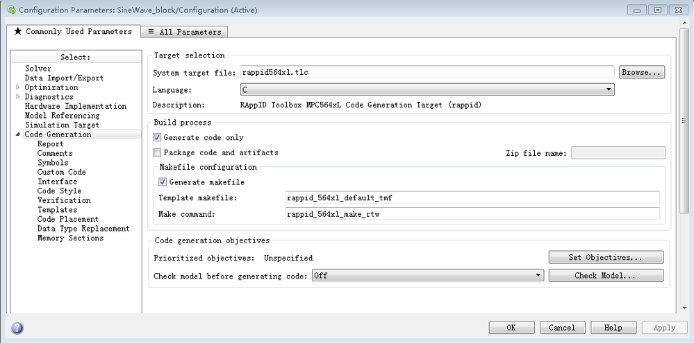

Thanks for the reply. But after building the model in Simulink, I didn't see .elf generated in the "_rappid_rwt" folder?
The setting of code generation is as below
Thanks.

Hi Zili,
   I found the issue, you have the option 'Generated code only' enabled, please see below. By default the examples don't have that option selected.
Radu

Hi Radu,
I tried to deselect the option of 'Generate code only', but .elf file is still not generated.

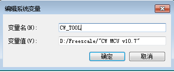

zili
Hi Radu,
I wasn't aware of the diagnostic viewer. The error is not like you mentioned. I guess there is something wrong with the Assembler details.
I have both CW2.1 and CW10.7 installed. In order to make the embedded coder find CW10.7. I deleted the environment variable of MW_TOOL for CW2.1 and created CW_TOOL for CW10.7 with the value of D:/Freescale/"CW MCU v10.7".
=== Build (Elapsed: 15 sec) ===

C:\Freescale\Sin_Gen\SineWave_block_rappid_rtw>set MATLAB=C:\MATLAB\R2016a
C:\Freescale\Sin_Gen\SineWave_block_rappid_rtw>"C:\MATLAB\R2016a\bin\win64\gmake" -f SineWave_block.mk GENERATE_ERT_S_FUNCTION=0 INCLUDE_MDL_TERMINATE_FCN=1 COMBINE_OUTPUT_UPDATE_FCNS=1 MULTI_INSTANCE_CODE=0 INTEGER_CODE=0 ISPROTECTINGMODEL=NOTPROTECTING
clean
RELATIVE_PATH_TO_ANCHOR is ..
==== Removing object files from build directory ====
Copying necessary files to build directory...
Compiler details : "D:/Freescale/"CW MCU v10.7"/MCU/PA_Tools/Command_Line_Tools/mwcceppc" -vle -DVLE_IS_ON -gdwarf-2 -fp spfp_only -spe_vector -char unsigned -proc Zen -gccincludes -nostdinc -nosyspath -ansi off -opt all -bool on -Cpp_exceptions off -prefix "D:/Freescale/"CW MCU v10.7"/MCU/PA_Support/ewl/EWL_C/include/lib_ewl.prefix" -I. -I.. -I"C:\MATLAB\R2016a"\simulink\include -I"C:\MATLAB\R2016a"\extern\include -I"C:\MATLAB\R2016a"\rtw\c\src -I"C:\MATLAB\R2016a"\rtw\c\libsrc -I"C:\MATLAB\R2016a"\rtw\c\src\ext_mode\common -I"C:\MATLAB\R2016a"\rtw\c\src\ext_mode\tcpip -I"C:\MATLAB\R2016a"\rtw\c\src\ext_mode\serial -I"C:\MATLAB\R2016a"\rtw\c\src\ext_mode\custom -I"D:/Freescale/"CW MCU v10.7"/MCU/PA_Support/ewl/EWL_Runtime/Runtime_PA/Include" -I"D:/Freescale/"CW MCU v10.7"/MCU/PA_Support/ewl/EWL_Runtime/Runtime_PA/Source" -I"D:/Freescale/"CW MCU v10.7"/MCU/PA_Support/ewl/lib" -I"D:/Freescale/"CW MCU v10.7"/MCU/PA_Support/ewl/EWL_C/include" -I"D:/Freescale/"CW MCU v10.7"/MCU/PA_Support/ewl/EWL_C++/include" -IC:\MATLAB\R2016a\simulink\include\sf_runtime -IC:\Freescale\Sin_Gen\SineWave_block_rappid_rtw -IC:\Freescale\Sin_Gen -DUSE_RTMODEL -DMODEL=SineWave_block -DREAL_T=float -DRT -DNUMST=1 -DTID01EQ=0 -DNCSTATES=0 -DMT=0 -DHAVESTDIO -c
Assembler details : "D:/Freescale/"CW MCU v10.7"/MCU/PA_Tools/Command_Line_Tools/mwasmeppc" -vle -DVLE_IS_ON -proc Zen -list -gccincludes -nostdinc -c
Building assembly file crt0.o...
'"D:/Freescale/"CW' is not recoginzed as internal or external command
operable program or batch file.
gmake: *** [crt0.o] Error 1
### Build procedure for model: 'SineWave_block' aborted due to an error.
Build process completed successfully
As instructed in the MCT Installation quick start manual, I use '' '' around any directory that have spaces in the names. Is it wrong?
