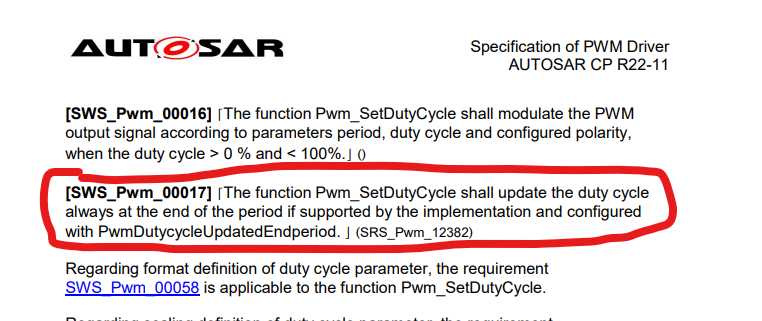

Going back to your initial inquiry, I can say that I am not an AUTOSAR expert, but I have done some research and I have found out the following AUTOSAR PWM Driver requirement.
I honestly don't know why, but it seems that AUTOSAR PWM driver does not support the half-cycle reload.
When you select PwmDutyCycleUpdatedEndperiod or PwmPeriodUpdatedEndperiod, AUTOSAR requires that updates occur only at the end of the PWM period. This maps directly to full‑cycle reload only in eFlexPWM. Because half‑cycle reload contradicts AUTOSAR semantics, the S32CT blocks it.

As a conclusion, the S32CT enforces AUTOSAR PWM driver rules. When you select “PwmDutyCycleUpdatedEndperiod” or “PwmPeriodUpdatedEndperiod”, the AUTOSAR specification requires that updates occur only at the end of the PWM period.
What you could do to overcome this driver limitation is to directly overwrite the SMn_CTRL[LDMOD] register in your model, using custom code blocks. But, I am not sure if it will work. It has to be tested. However, to overcome the PwmDutyCycleUpdatedEndperiod macro check from the Pwm_SetDutyCyle function, the duty cycle values has to be as well directly written to the SMnVALx registers, using custom code blocks.
