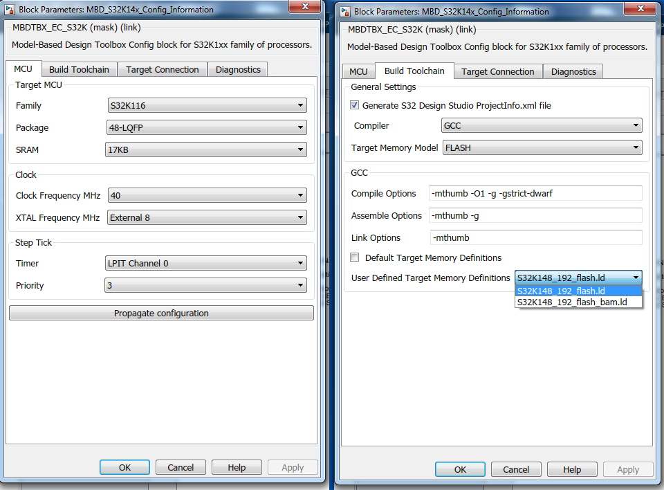

I'm using S32K1xx v4.1.0 toolbox. In the main Config block of the model after unchecking the 'Default Target Memory Definitions' I can see only 2 options to choose from:'S32K148_192_flash.ld' and 'S32K148_192_flash_bam.ld'. It does not matter what target MCU is selected.
I've looked through installation catalog of MBD Toolbox - and there are multiple directories with linker script files. But I couldn't find one with only these two (visible in 'Config' block) linker scripts.
How can I tell the MBD Toolbox to link using my custom linker script ?

Hi again mariuslucianandrei,
after replacing the provided model in "...\Add-Ons\Toolboxes\NXP_MBDToolbox_S32K1xx\mbdtbx_s32k" there is no change in behavior.
For example below is what I see after setting MCU to S32K116 (after saving/reopening model, selecting MCU again, changing it etc.). As You see other fields are re-populated correctly - only linker files are broken:
I can still export the project to S32DS and change the linker to whatever I like - but it's a time consuming process and for quick prototyping the best solution is to change the linker script in Config block as intended in the Toolbox.

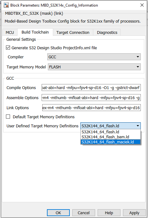

Hi, https://community.nxp.com/t5/user/viewprofilepage/user-id/72088
we are working with S32K toolbox v4.2.0 for about 2 weeks now. I can confirm that exporting projects with referenced models to S32 Design Studio works now! (It didn't work in earlier version which was a big problem).
Unfortunately we still see the same problem with the custom linker files as before. This problem was NOT present immediately after the installation ! As I remember we have checked this on the 1st or 2nd day of using new version - and it was working ! We have been able to switch linker files as intended.
Yesterday I've included new custom linker file into the appriopriate catalog and have tried to change the linker file in config. block - results the same as I've described at the start of this post. I always see only two S32K148 linker files (the two for default processor in config. block) - nothing else - independent of the choosen processor. And from this experience it looks like this feature is blocked at some point during using the tools. (we use the toolbox constantly).
Any new info about this ?

Maciek
Contributor V
@https://community.nxp.com/t5/user/viewprofilepage/user-id/72088
We have installed (and are using) the toolbox v4.2.0 in Matlab R2020a.
