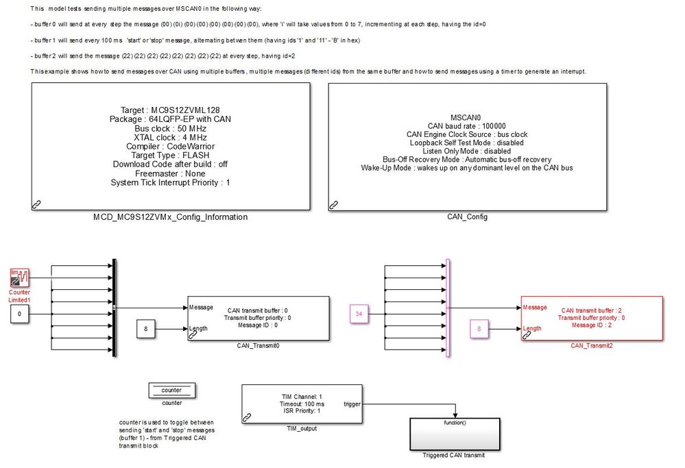

eungsoolee
I followed your advice....
But...The error message disappears in matlab, but the CAN application SW does not work properly.
                               <Snapshot of CAN application SW monitoring using CANoe>
Have you sent more than 2 messages using the model?
The attached file below is Application SW for CAN Test.
Can you check the wrong part of my model?
5,125 次查看
Daniel_Popa
Hi Eungsoo Lee,
We found the problem and thanks to you eungsoolee we can now provide a hotfix, but first we would like to have your confirmation that works OK on your setup.
Please do the following steps:
#1: go to ..\MCToolbox\mctbx_9s12zvm\mctbx_s12zvmc256\src\c_library\ folder
#2: make a back-up copy of the mscan0_s12zvmc256.c file
#3: copy-paste the file attached mscan0_s12zvmc256.c file into this thread that contains the fix to ..\MCToolbox\mctbx_9s12zvm\mctbx_s12zvmc256\src\c_library\
#4: start Matlab and clean up the previous generated code (delete the entire folder that was generated for your model)
#5: regenerate the code for your model
Now it should work fine.
In addition please find attached a model we used to validate the fix. You may want to adapt it for your setup.
Hope this helps!
Once we have your confirmation that everything is fine we can then prepare an official hotfix patch.
Thank you!

Daniel_Popa
Hi eungsoo Lee,
I'm going to have a look - i suspect an issue in the toolbox.
We did test it for multiple CAN msgs but from a single buffer. It like a function call that send a new data buffer to be transmitted at each step.
Give us some time to look in details and we'll come back with a resolution.
Thank you for your patience!

Hi eungsoo Lee,
Let us try first to get rid of the errors and confirm you can sent more messages using this setup.
Go to your install directory for the toolbox and look for a file called: {install dir}\mctbx_9s12zvm\mctbx_s12zvmc256\mctbx_s12zvmc256\mscripts\mcd_s12zvmc256_block_mscan0_check.p
This file is responsible for consistency checks. Just rename the file extension from .p -> .none
This hack will prevent Matlab to load the functions for checking the consistencies.
Then, reload your model (it would be good to restart the Matlab) and compile. The error msg should be gone. Test your application to see if your get your msg sent over CAN network.
If the application works then we can give you a hot fix for this issue.
