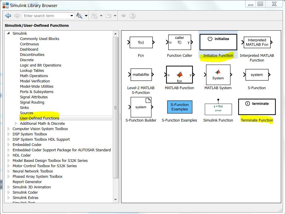

Simulink generated code has 3 main functions:
- step()
- initialize()
- terminate()

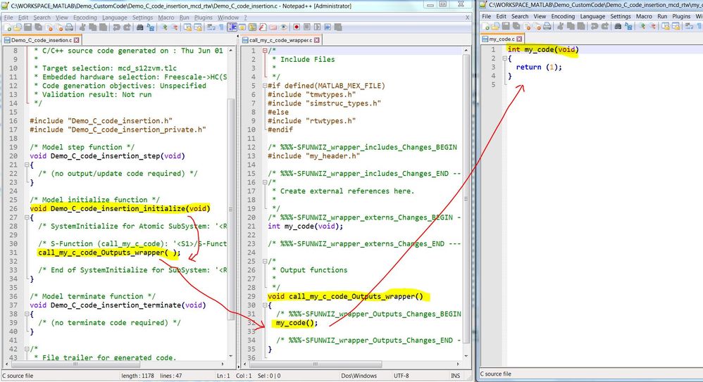

You need to inject the code into the initialize function because that is called only once in the beginning.

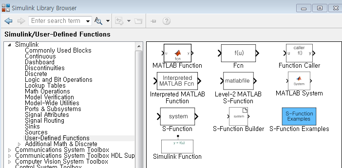

You can do this by using 2 standard (S-Function Builder and Initialize Function) Simulink blocks and one file from the Toolbox (mcd_s12zvm_user_copy_required_files.m)
The procedure is like this (an example is attached)

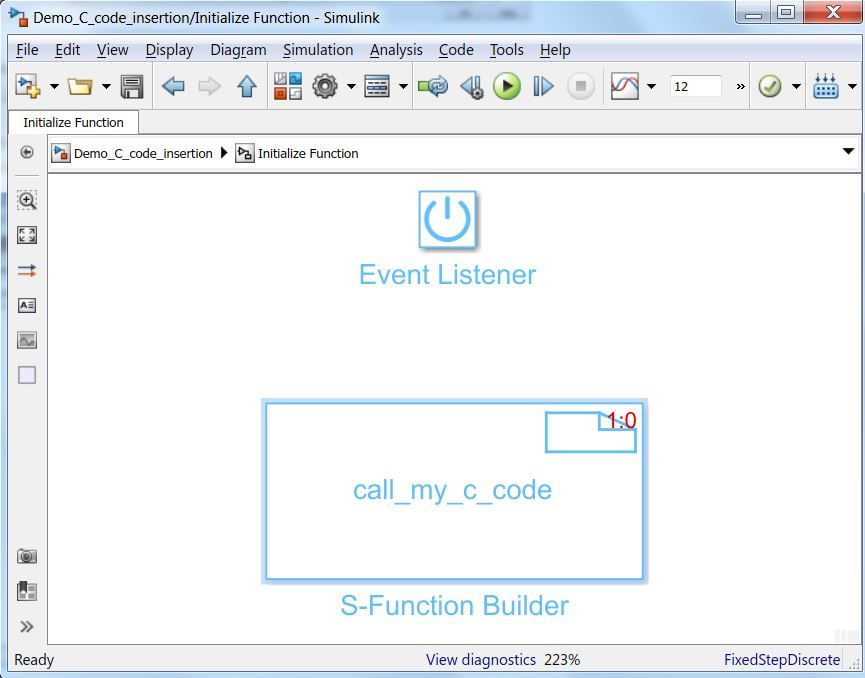

1: First you add the Initialize Function Block into your model
2: inside the Initialize function you add the S-Function Builder
3: inside the S-Function Builder you call your custom C-functions/C-files/C-headers

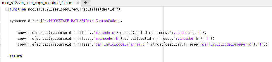

4: Use Toolbox Custom file copy to move all the custom files into the automatic generated folder before building the application
5: You build the application and check if the code was injected in the right place.

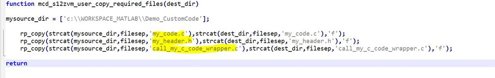

Please find attached an example - all you have to do is to:
- copy and replace the file: mcd_s12zvm_user_copy_required_files.m into c:\MCToolbox\mctbx_9s12zvm\mctbx_s12zvm\mctbx_s12zvm\mscripts\ folder
- add you own code into my_code function.

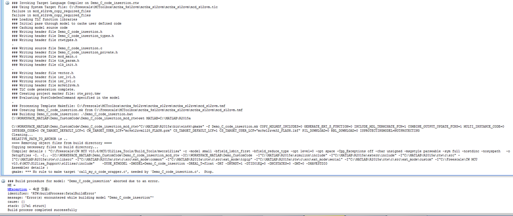

byeongjinkim
A build error occurs.
matlab version : 2015a
you attached '*.slx' file is 2016 version. so, not open.
i used '.mdl' file.
what is the command "rp_copy"?
this is not find matlab command.
12,796 Views
Daniel_Popa
The build error indicates that the custom files were not copied inside the *_mcd_rtw folder where those are needed to be.The  rp_copy is a toolbox function.Try the open the m file in the MATLAB editor and place a breakpoint and then build again. Does the breakpoint gets hit?If  not then the file was not copied in the location expected by the toolbox.

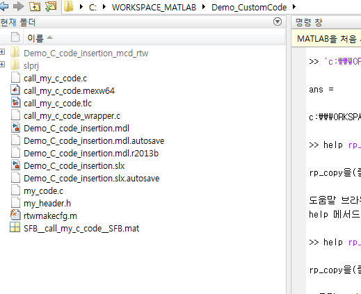

byeongjinkim
initialize function block is not supported in simulink of matlab version 2015a.
matlab command "help rp_copy" --> not find rp_copy
rp_copy is wrong. The exact command is "copyfile".
after corrected command, compile is right operating.
