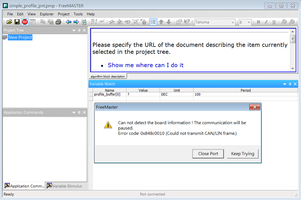

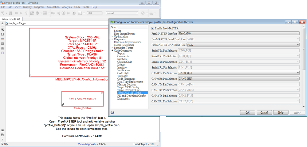

I use the example file " simple_profile_pnt.mdl " and change the setting for FlexCAN0(500K).
And open the Freemaster project " simple_profile_pnt.pmp " , the error screen as follows:

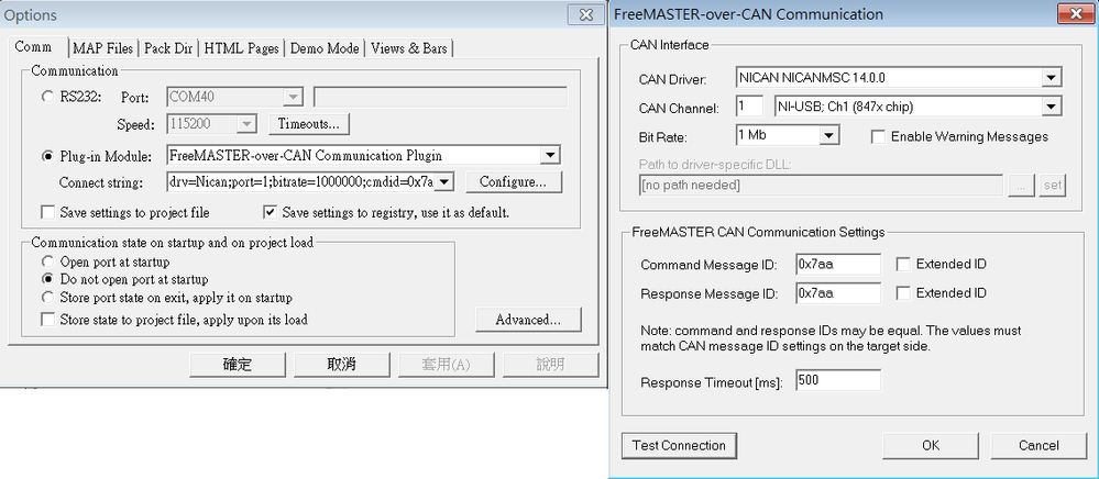

Freemaster configuration is as follows:
My adapter is "NI USB-8473" in the list of supported devices, and I used the adapter for MCToolbox(rappid564xl) before.

Hi rogerdai‌,
I see that in the FreeMASTER project you set the bit rate to 1Mb, but in the Simulink model you set the baud rate to 500K. Try to see the baud rate to 1M in the model too.

rogerdai
Hi Paul:
Thanks your reply.
I try to change bit rate to 500Kb in the FreeMASTER, but the result is same.

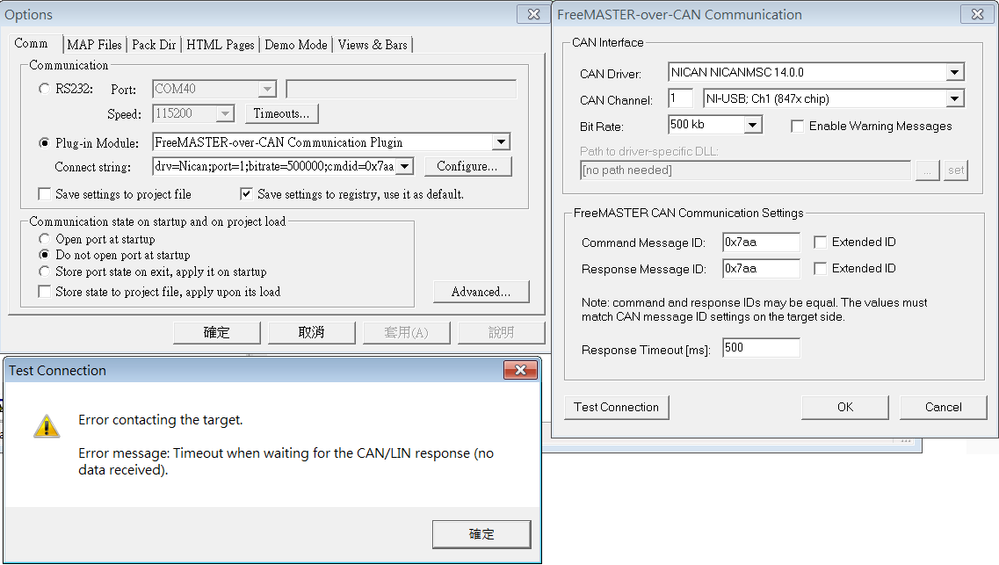

And I push "Test Connection" buttom is as follows:
Thanks a lot.
Roger

rogerdai
Hi Daniel:
Thanks your reply.
I have looking the issue How do I use Freemaster for MBD toolbox MPC5744P rev2.0.0
But his error code and adapter is different.
I try to replace "mbdtargetmainlibpnt.tlc", but result is same.
processor: SPC5744PFMLQ9
toolbox version: 2.0.0
Looking forward for your reply.
Thanks a lot.
Roger
