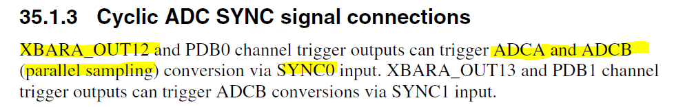

In order to trigger directly the ADC interrupt from the flexPWM block you need to do the following changes:
1. Select output Triggers from the Three_Phase_Output block (for the example attached I chose PWM A VAL3 - falling edge of the A[0] output pin). In order to understand what output triggers you need to choose, please read from the Kinetis RM the Functional Description of the eFlexPWM, Chapter 38.

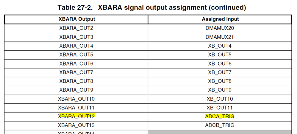

2. For ADC_Config, you need to choose the XBARA output 12 and then as ADC XBARA Trigger you need to select one according to previously selected trigger (Three_Phase_Output); please read in the same RM, Chapter 27.

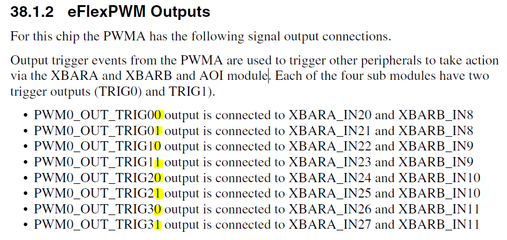

In the Reference Manual I found this:
This is why I configure this in the ADC Config Block:

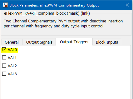

In the PWM Block different values are available.

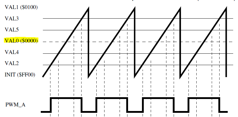

In center alaigned type these are:
So I configure the following in the PWM Block:
So in the Reference Manual I found this:
--> In my opinion the yellow marked numbers in the picture above are the VAL0, VAL1, VAL2 and VAL3 which you can choose in the PWM Block, correct so far ?
--> The second number marked in the picture above should be the TRIG0 or TRIG1 ?
Because I activate VAL0 I would ecpect the connection to XBARA_IN21. (second line in the picture above: PWM0_OUT_TRIG01)
But XBARA_IN21 has PWMA0_TRIG1 as assigned output.
So why I have to configure PWMA0_Trigger 0 in the ADC Config Block as ADCA XBARA Trigger ?

I've tried some configurations in order to understand the correct timing.
If I choose VAL3 everything is fine and I can control the signals with my oszilloscope !!
But with Output Trigger VAL0 (for measuring in the middle of PWM_A) the model doesn't run anymore...
I don't know why...?! Do you have an idea ?
Do I have to set some priorities in this case ?
3,732 Views
mariuslucianand
Hello lethuer2‌,
In order to use VAL0 as Output Trigger you need to select in the ADC_Config  for "ADCA XBARA Trigger" the value "PWM0 Trigger 0" (in the first image of the previous answer).
