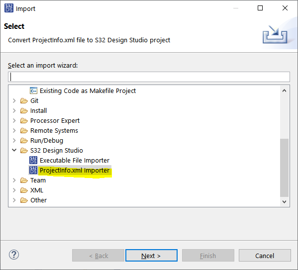

constantinrazva
Hello utkuckmgl@gmail.com ,
Ok, thank you for the information. Now regarding the building / importing -- can you go through the steps you took? For the building process, you just have to hit the build button (or CTRL + B). I have to mention the fact that if you want to take the code generated and import it into S32 Design Studio, you have to have an option set in the main configuration block (where you select the MCU for which the application is built, among other things). Here, in the Build toolchain tab you'll find 'Generate S32 Design Studio ProjectInfo.xml file' -- make sure this is enabled (checked).
After the build is done, a file with the name ProjectInfo.xml should be generated. You can go into S32Design Studio -> Import -> S32Design Studio -> ProjectInfo.xml Importer
From there you just browse and select your ProjectInfo.xml file. Let me know if it works after you do all these steps I described.
Kind regards,
Razvan.
P.S.: you can find an introductory video about MBDT here Get to Know the User-Friendly NXP MBDT for Application Development in MATLAB/Simulink | NXP . I thought this might be helpful. It is part of a 4-video mini-series. You can find the other 3 linked on the same page. The other topics are SPI communication, CAN communication and PWM.
17,655件の閲覧回数
utkuckmgl
Hello Constantin Razvan Chivu,
I'm very grateful, it worked fine. Now I can build project, but still have some errors when I builded it. I directly generate and build as you said, didn't do anything with code but I have errors as;

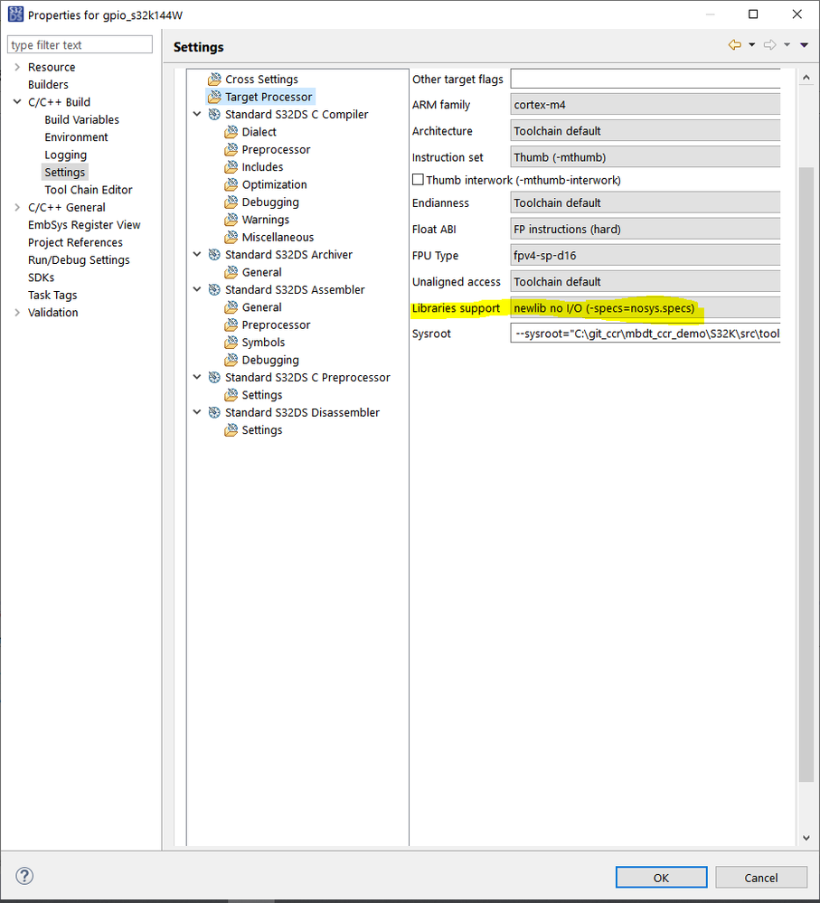

constantinrazva
This is a bit strange - could you right click on the project -> Properties then go to C/C++ Build -> Settings -> Target Processor -- from there can you make sure that Libraries support is set to newlib no I/O (-specs=nosys.specs) like in the image below?
Kind regards,
Razvan.
17,655件の閲覧回数
utkuckmgl
Yes it is set. But sysroot is different, I'm not sure if it changes anything to cause errors.
17,655件の閲覧回数
constantinrazva
Can you change the sysroot to
"[your_toolbox_root_directory]\tools\gcc-6.3-arm32-eabi/arm-none-eabi/newlib"
and try again?
Kind regards,
Razvan.
17,655件の閲覧回数
utkuckmgl
And now errors has gone but I have just 2 more left :smileysad:
17,655件の閲覧回数
constantinrazva
Can you check to see if you have a correct path in Settings -> Standard S32DS C Linker -> Libraries, under library search path? You should see {TOOLBOX_ROOT}/mbdtbx_s32k14x/AMMCLIB_s32k14x/lib/gcc, like in the image below:
Kind regards,
Razvan.
