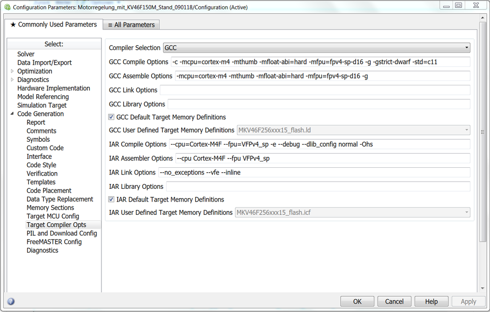

I want to set up the GCC Compiler to test if there is a difference to the IAR Compiler.

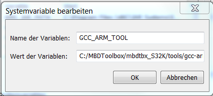

Therefore I've set up the Environment variable like shown below:
the complete path is this: "C:/MBDToolbox/mbdtbx_S32K/tools/gcc-arm-none-eabi-4_9"
But I'm not using the S32K ! I want to use the KV4x.
But it should be possible to use the GCC Compiler, right ?
During the build procedure I get this message:
fsl_gpio_irq.c:60:3: error: 'for' loop initial declarations are only allowed in C99 or C11 mode
       for (uint8_t i = 0; i < 32; ++i) {
    fsl_gpio_irq.c:60:3: note: use option -std=c99, -std=gnu99, -std=c11 or -std=gnu11 to compile your code
As an attachment you get the build Report.
Also with C11 or C99 I get an error:
    C:/MBDToolbox/mbdtbx_S32K/tools/gcc-arm-none-eabi-4_9/bin/arm-none-eabi-ld: cannot find CM04_MMCLIB_CW.a: No such file or directory
    C:/MBDToolbox/mbdtbx_S32K/tools/gcc-arm-none-eabi-4_9/bin/arm-none-eabi-ld: cannot find -lm
    C:/MBDToolbox/mbdtbx_S32K/tools/gcc-arm-none-eabi-4_9/bin/arm-none-eabi-ld: cannot find -lc
    C:/MBDToolbox/mbdtbx_S32K/tools/gcc-arm-none-eabi-4_9/bin/arm-none-eabi-ld: cannot find -lgcc
    gmake: *** [Motorregelung_mit_KV46F150M_Stand_090118_GCC.elf] Error 1
    ### Build procedure for model: 'Motorregelung_mit_KV46F150M_Stand_090118_GCC' aborted due to an error.
    Error make_rtw: exception id RTW:buildProcess:fatalBuildError  message Error(s) encountered while building "Motorregelung_mit_KV46F150M_Stand_090118_GCC"
The target compile Options are configured like this:
Are the Settings correct for the KV4x Controller ?

#3: Define the GCC_ARM_TOOL system variable to point to GCC compiler toolchain.
For verification we used the compiler delivered with Model Based Design Toolbox for S32K rev 2.0.0 but you could use the one shipped with S32DS IDE as well.
e.g. GCC_ARM_TOOL = C:\MBDToolbox\mbdtbx_S32K\tools\gcc-arm-none-eabi-4_9

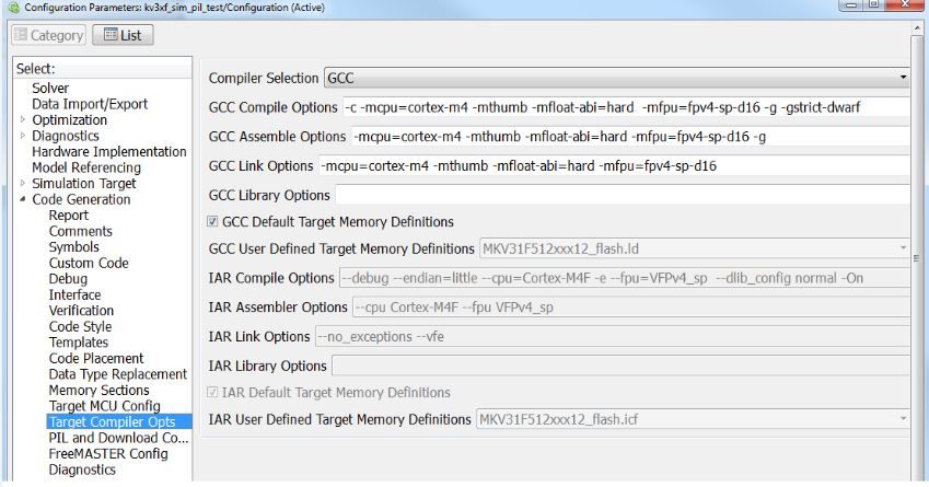

#1: The GCC options should be:
GCC Compile: -c -mcpu=cortex-m4 -mthumb -mfloat-abi=hard -mfpu=fpv4-sp-d16 -g -gstrict-dwarf
GCC Assemble: -mcpu=cortex-m4 -mfloat-abi=hard -mfpu=fpv4-sp-d16 -g
GCC Link: -mcpu=cortex-m4 -mthumb -mfloat-abi=hard -mfpu=fpv4-sp-d16
Hope this helps!
