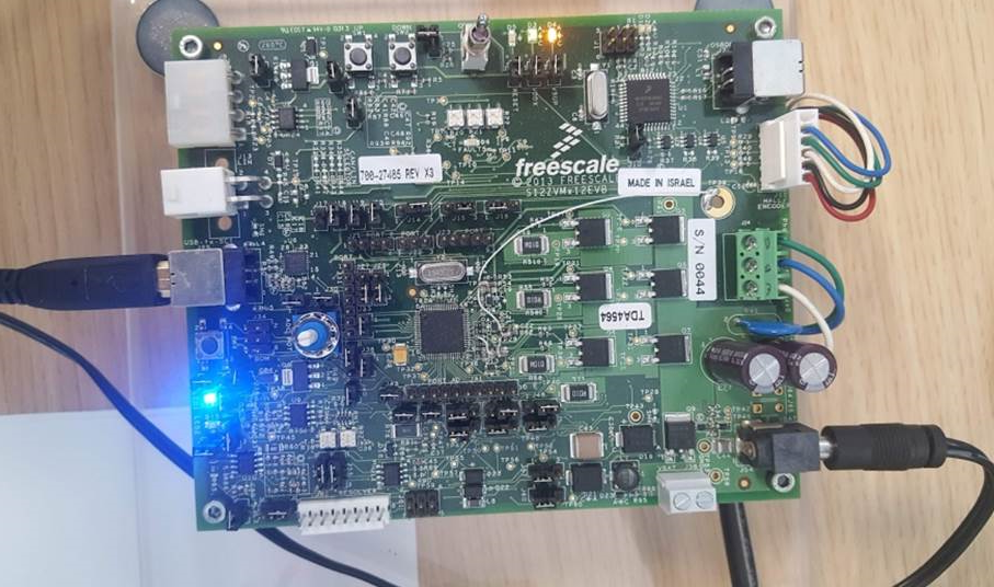

Daniel_Popa
Hi thomsonzhou‌,
The board is S12ZVM EVB: S12ZVM Evaluation Board|NXP
Here is a snapshot with it running FOC.
8,268 Views

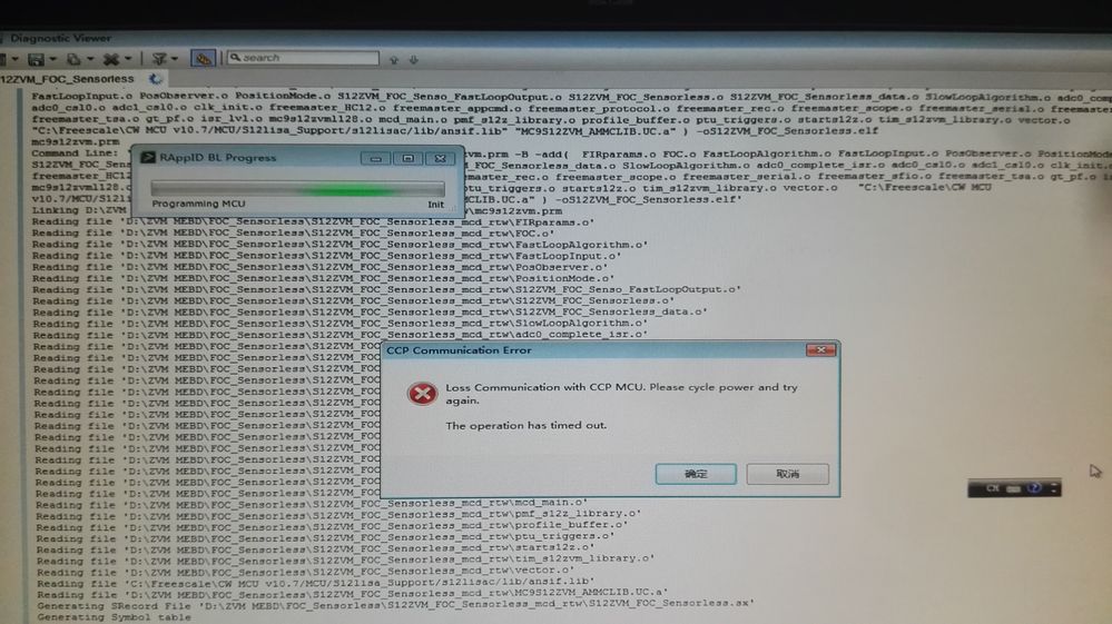

amosxue
Hi, Daniel,
      I have download the Example Model: S12ZVM FOC Sensorless Motor Control and setup the toolbox for S12ZVM successfully. After I debug the Model in Simulink, restart my EVB Board, then there is a Error, shown in the picture. I have checked the port in my computer is COM6, and have Config 6 in the model. I wondered if I missed something?微信图片_20181120183853.jpg
8,268 Views
constantinrazva
Hello amosxue‌,
Did you by accident overwrite the bootloader? If you have entered in debugging on the board and did not put the bootloader back, the RappidBL would give you a loss of communication error. To make sure that's not the problem, you can re-flash the S12ZVM.rbf to the board and then build & download again, from Simulink.
Hope this helps,
Razvan.

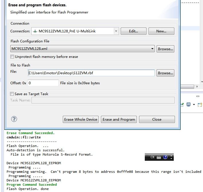

amosxue
Hello, Razvan,
        I have downloaded the example AN5327, and debug it in CW10.7 early. The bootloader is overwrited probably.
        Today, I flash S12ZVM.rbf in CW10.7, as the figure below, there is a warning:
         Programming warning. Can't program 8 bytes to address 0xfffe08 because this range isn't included in the selected modules!
         Programming .....
         Device MC9S12ZVML128_EEPROM
         My EVB is S12ZVML12EVBLIN, the chip is s912ZVML12 MKH.
         I want to what cause this warning, and how to fix it.
         Amos

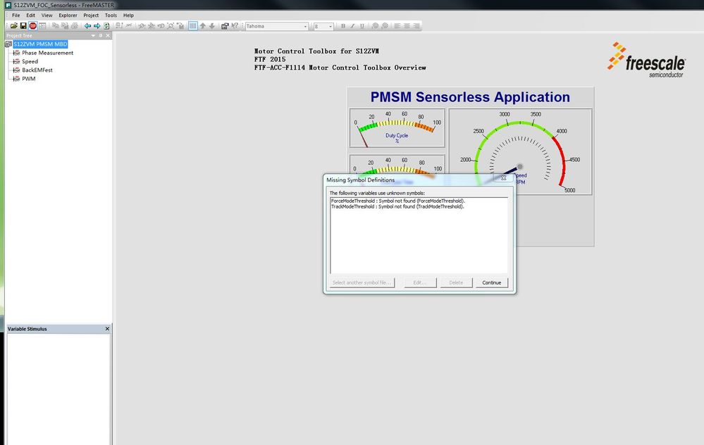

thomsonzhou
Thank you very much! Your reply is very helpful to me. My problem has been resolved.
And here is my story:
I used FreeMaster2.0 with a P&E Micro can send speed command to target board.
Everytime, when use the FOC models generate the C code automatically, there is a  pmp file inthe
target folder.
When I use freemaster2.0 open this s12zfoc.pmp project file it always show variable missing information to me.
I need to send speed command to target board with freemaster2.0.
But everytime, when I click the stop sign button, the motor does not run at all with duty cycle meter, executing time meter and tacometer changed.
Should I need to create my own freemaster command for making foc motor rotate? For your references, my freemaster2.0 command list is
empty as below picture. How to makes motor rotate with freemaster? And furthremore,
How can I make my motor retates without freemaster speed command request?
I want to make my motor rotate when the board is powered on.
Furhther more, when I use an oscilliscope to test the corresponding pins of PWM output there is no any signal output.
So, I guess, my target does not receive the speed request command at all.
Is the SCI(RX, TX) serial port is the only way to send speed command to my motor ?
Need you help.
