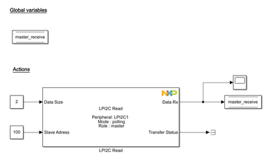

For a first test i created the following model to receive the data from the i2c sensor over the external mode:
The code generation (Monitor&Tune) is working, but when i connect to the board and press the start button i cannot see anything in the scope. Do I make any mistakes?

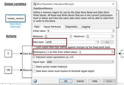

Why has the block output Data Rx the size unit8, although i request a size of 2 bytes?
Moritz

nxa11767
Hi @allmo ,
The size of Data Rx is an array of uint8 elements, so you'll need to define the size of your data storage variable that will be used to store the Data Rx:

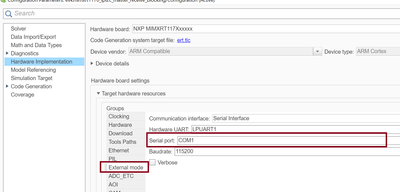

As for external mode, have you set the correct COM port in the Model Hardware Settings?
Do you get any errors in the Diagnostics view?
Alexandra

allmo
Hello @nxa11767
i changed the block parameters in the data store memory.
I have checked the com port too. It is the same one as in the device manager of windows.
As stop time of the model i choosed "inf", I hope that's right.

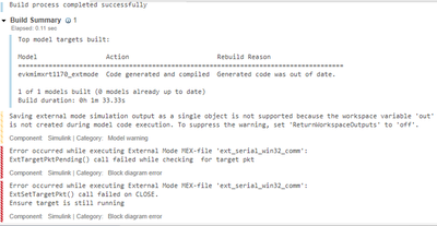

When i try to connect with the board after i pressed the restart button, I got the following error message (see file error_simulink.txt)
Moritz

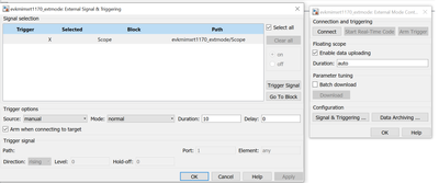

nxa11767
Hi @allmo ,
Try decreasing the  Duration  in Signal&Trigger options, in External Mode Control Panel:
The toolbox provides also an example for external mode (evkmimxrt1170_extmode.slx), you can try to run that one also.

allmo
Hello @nxa11767
i have decreased the duration setting in the signal and trigger options, but i got a new error message
As i proposed i testet the external mode example of the toolbox. After I had set the correct settings, the example ran.
Then I inserted the i2c-blocks to the exampel model to test, whether the error depend on the model setting. After I have compiled the model with the inserted blocks, i unfortunaly  got the same errros.
Bes regards,
Moritz

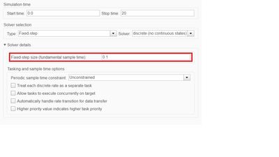

stefancinipeanu
Hello @allmo
I have a few suggestions for external mode working.
If your Simulink model is saved as .mdl, try to save it as .slx and then run external mode again.
Also, I recommend to set a specific fixed step-size in the solver configuration for your model.
Make sure that the COM port associated with your board is not open or used by another process. Otherwise, your board cannot send data to Simulink.
Also, make sure that the sensor you are using is sending data to your board. The communication between Simulink and the board might be cut off because the board might be stuck in an I2C call function waiting for the data from the slave device.
If your are trying just to visualize the data your are receiving, you can use FreeMaster tool which is supported by our toolbox. The FreeMaster blocks can be found in the Utility Blocks from NXP Model-Based Design Toolbox for i.MX RT MCUs in Simulink Library Browser.
Stefan
