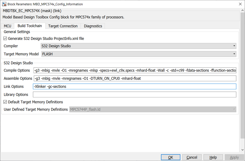

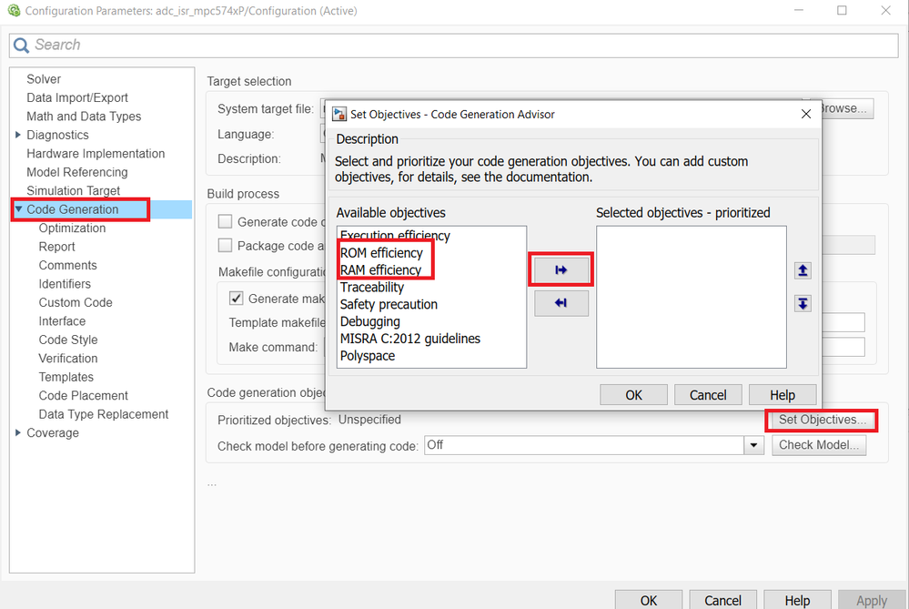

  2. enable optimizations related with code size (if the .text is larger) or data size (if .data is larger). This can be done from 2 stages:
    • Stage Code-Generation in MATLAB settings to control how the generated code will look like.pastedImage_3.png
    • Stage Cross Compiler arguments that controls how the compiler generates the final application code. Here you can change the optimization level or add the -Os. More on the compile optimizations here: Using the GNU Compiler Collection (GCC): Optimize Options pastedImage_4.png

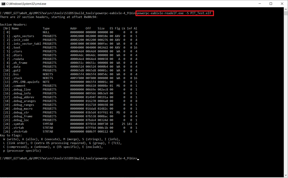

What is the content of the .elf file?
ELF is just a container. The Bootloader do not use all the information from this file. For the application to work on the MCU all you need are specific sections of .text, .data, .bss
A very good explanation of the elf file can be found here: Executable and Linkable Format - Wikipedia
NXP is offering elf dump tools that allows you to parse the elf and see exactly what is inside. You can find this tools inside the ..\\tools\S32DS\build_tools\powerpc-eabivle-4_9\bin\ of your MBDT installation.
As you can see, almost half of the sections are related with debug information. These sections are NOT flashed into the MCU memory. They exist only in the elf and ONLY an IDE/Debugger running on the host PC can access such information.
Look for A flag. Only the sections that have A-allocation flag will be written to the target.
