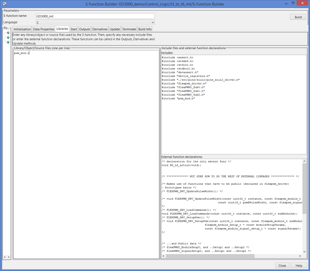

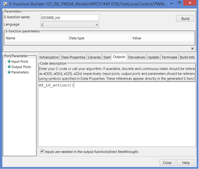

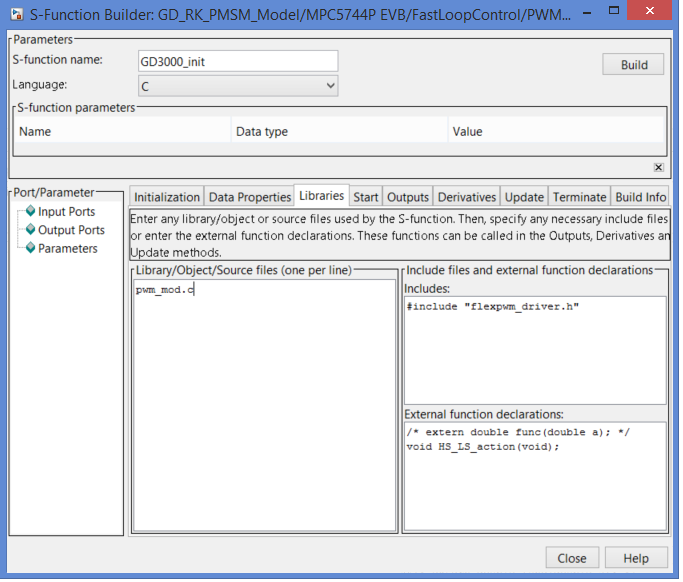

stuart_jobbins
Thanks Marius,
I think I got past that last night.

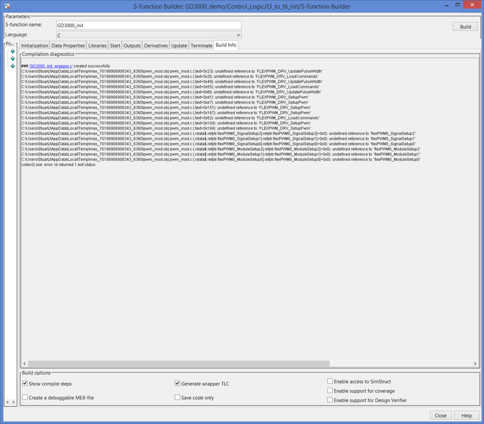

I am now left with a simple model and a simpel bit of C Code, which I think I have all teh header dependencies sorted (with local copies ccahed from earlier builds)...
...but I still don't know how to connect to the FlexPWM Functions (i.e. resolve the external function calls to them) or connect with the FlexPWM0_Sub Module (0,1,2) data structures.
As you will see these come up as unresolved external references.
The text in the External reference part of the Libraries tab gives you my problem areas. I'm not even sure if this is the right place to declare them to the S Function (as it seems to need to resolve them). The Matlab S Function examples don't attempt anything like this.
Bottom right box in Library tab...
* declaration for the only extern func */
void HS_LS_action(void);
/* ************* NOT SURE HOW TO DO THE REST OF EXTERNAL LINKAGES ************** */
/* Makes use of functions that have to be public (declared in flexpwm_driver)
- Prototypes below */
/* FLEXPWM_DRV_UpdatePulseWidth(); */
/* void FLEXPWM_DRV_UpdatePulseWidth(const uint32_t instance, const flexpwm_module_t subModule, const uint16_t pwmAPulseWidth,
const uint16_t pwmBPulseWidth, const flexpwm_signal_type_t pwmType);
/* FLEXPWM_DRV_LoadCommands(); */
void FLEXPWM_DRV_LoadCommands(const uint32_t instance, const uint32_t subModules);
/* FLEXPWM_DRV_SetupPwm(); */
/* void FLEXPWM_DRV_SetupPwm(const uint32_t instance, const flexpwm_module_t subModule,
flexpwm_module_setup_t * const moduleSetupParams,
const flexpwm_module_signal_setup_t * const signalParams);
/* ...and Public data */
/* flexPWM0_ModuleSeup0, and ..Setup1 and ..Setup2 */
/* flexPWM0_SignalSetup0, and ..Setup1 and ..Setup2 */
/*flexpwm0_0_module_setup_t declaration */
/* extern flexpwm_module_setup_t flexPWM0_ModuleSetup0; */
/*flexpwm0_0_module_signal_setup_t declaration */
/* extern flexpwm_module_signal_setup_t flexPWM0_SignalSetup0; */
/*flexpwm0_1_module_setup_t declaration */
/* extern flexpwm_module_setup_t flexPWM0_ModuleSetup1; */
/*flexpwm0_1_module_signal_setup_t declaration */
/* extern flexpwm_module_signal_setup_t flexPWM0_SignalSetup1; */
/*flexpwm0_2_module_setup_t declaration */
/* extern flexpwm_module_setup_t flexPWM0_ModuleSetup2; */
/*flexpwm0_2_module_signal_setup_t declaration */
/* extern flexpwm_module_signal_setup_t flexPWM0_SignalSetup2; */
Any guidance would be appreciated.
Happy to send you a cut-down model and the code (I fixed the syntactic errors from previously)...
Stuart
10,130 Views
stuart_jobbins
Marius,
I think the following code snippet gives you an idea of what I am trying to do to match the GD3000 initialisation specification need...
...but I'm not sure changing the channel pair mode setting will achieved the desired result, but the idea is to launch it from within the GD3000 set-up to replace states t3 to t6, to get the required LS and HS drive toggles.
Phases A, B andC on PWM0, Submodules 0, 1 and 2 respectively.
The real question is how I get these functions into the 'build system'... I can enclose as an S-function, but can't integrate into the build tlc.

You can insert the above code either by using the S-function like in this threadAbout Code generation in the Model Based Software  or by inserting some custom code using Simulink Coder like here https://community.nxp.com/message/1040943?commentID=1040943#comment-1040943
Hope this helps,
Marius

stuart_jobbins
I gave in last night and installed a 2nd instance of the MinGW compiler to use in Matlab (in addition to the one in eclipse/Cygwin) as well as the 2 compilers for the same target processor for 2 instances of S32DS (one standalone and one embedded in MBDT).
As you can see from the script above, I have a single entry point, single function call with no parameters, but I want to access the data sets and Function calls  (that will exist once the .p scripts have run and created sources, build is built) from the FlexPwm driver set, ideally using all the same definitions (as the build).
The problem I now have is that because of dependencies in the includes, and the S-function wishing to 'build' ahead of the .p scripts running, I cannot apparently satisfy this requirement.... without adding a (pre-built) version of all the dependent sources into my local build directory.
The examples you provide have basic 'standalone' functionality, or simple i/o functionality at the model... but I cant find an example that tries the level of 'symbolic' integration I want to achieve.Can it be done?
I assume I have to have more information declared to the S-Function builder, but its not clear what is needed.. as the S-Function builder appears to try and 'compile' the S-function BEFORE any of the model m scripts(p scripts) run to generate the build C sources.
(I obviously don't have a good mental model of how the libraries section of the S-Function builder is supposed to work!)
Can you point me to any example that does this... or do I just go through and re- define absolutely everything I need locally (in my build directory with a 'local' .h file?
pwm_mod.c - below

/* Make simultaneous changes to HS and LS FET states on submodules0, 1 and 2 of PWM0 */
volatile uint16_t i; /* Make this volatile so compiler doesn't optimise loops out */
/* Modify Channel mode of operation to 'Independent' to allow us to specifiy HS and LS movements using PWM duty */
Modify_PWM_Op_Ind();
/* Start with Both HS and LS off */
Force_HS_LS_Drive(0,0);
for (i=0, i < 50, i++){
/* Do nothing for approx 2.5us */
/* Turn LS On */
Force_HS_LS_Drive(0,1);
/* Wait for at least 1us - assumes 50ns inst time - ish */
for (i=0, i < 20, i++){
/* Do nothing */
/* Then turn LS off again - execution time of function call ensures no overlap, FETS are quick! */
/* Turn HS on */
Force_HS_LS_Drive(1,0);
/* Wait for a minimilast time 100ns plus deadtime is required, so lets say 250ns */
for (i=0, i < 5, i++){
/* Do nothing */
/* Turn off HS drive again... and then ready to go immediately without further delay */
/* Put back the original 'Complementary' mode of Channel Operation */
Modify_PWM_Op_Comp();
Basically I want to re-use the FlexPWM driver data structure and function calls (which should be 'public' by virtue of the FlexPWM_driver.h)... but it doesn't exist when I have to tell the S-Function builder to build. If I copy (a previously produced FlexPWM_driver .c/.h) into my local build directory.. it then complains about other dependencies... and so on... as I drag in more and more previously built .c/.h sources to my local build directory.
Any pointers on how to call C-functions (that exist outside my local source/build directory) would be appreciated.
