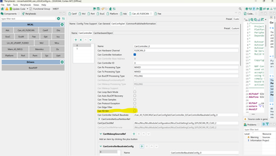

Hi All,
I'm working on the MR-CANHUBK344-S32.
I can run the tutorial: https://community.nxp.com/t5/NXP-Model-Based-Design-Tools/Communicating-over-the-CAN-Bus/ta-p/175845...
But, I cannot observe the CAN messages exchanged between CAN0 and CAN1 with my required hardware. I have to use a Kvaser Leaf Light v2 and I have to get those messages in a "standard CAN" format (the "old" version of CAN that is limited to 1000Kbps), not "CAN-FD" which is more recent and faster.
I tried several things but I can't figure out how to:
  • Get the same example working using the "old" CAN protocol with 500Kbps.
I tried unchecking this box:
I tried playing with the CAN FD baudrate to set it to 500Kbps, or simply removing the whole section "0", with no success.
I'm a little lost now. I'm sure it's super simple to solve but I'm not yet familiar enough with S32CT.
Thank you in advance for your help.
Aris

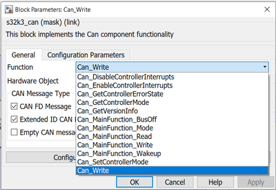

Hello @Aris_ ,
To clarify some things first, the option you unchecked in the configuration is not used to enable or disable CanFD, but to select the protocol it's using (ISO CanFD or non-iso CanFD):
In terms of sending normal Can frames (not FD), that should be achieved by simply opening the Can_Write block and unchecking the "Can FD Message" option, which you can see here:
Let me know if this helps and you start seeing the Can frames on your Kvaser Leaf Light v2.
Robert V

Aris_
Perfect! It works
