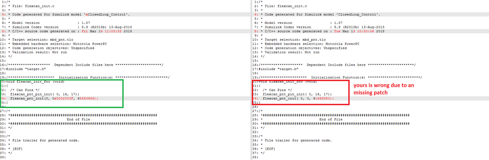

I have attached the files which I built using my compiler. Please have a look.

Sorry for delay. I've checked the code you have sent me.
The main difference between you generated code and mine is in the flexcan_init_fnc() function:
Please install HotFix_6 patch in order to fix it: https://community.nxp.com/thread/451804#comment-954427
This is a cumulative patch that fix the issue.
