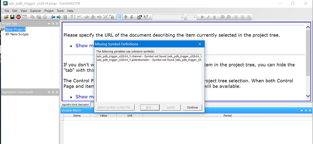

In the Motor Control Development Toolbox examples, adc_pdb_trigger_s32k14.pmp, report errors.1494820221(1).jpg

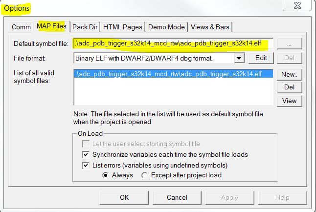

The FreeMASTER loads the symbols from the elf file. It needs that file to exists in a special location.
Can you check you have the elf file after generation the code from Matlab? In case you have compilation error that file might not exist and therefore FreeMASTER will not find the symbols.

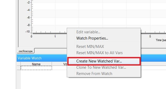

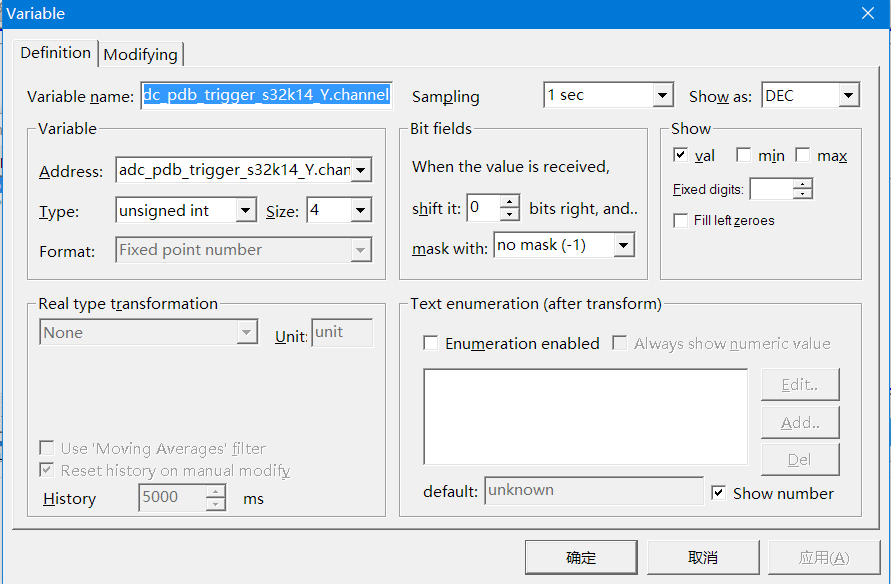

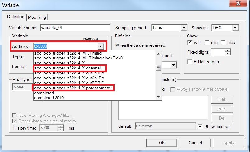

An easy way to double check the symbols exists is to right click on Variable Watch View and select Create New Watched Var option.
And then search the list of symbols for the needed ones:
