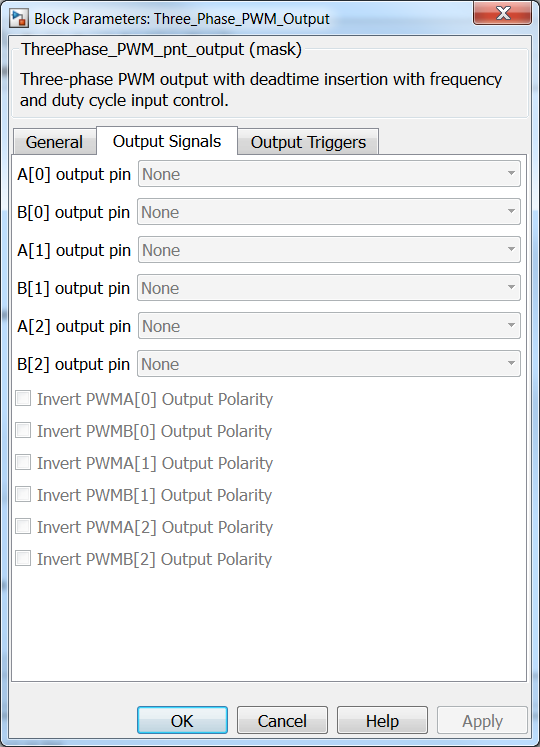

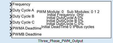

That works as design - to prevent configuration issues. Imagine what would happen if in the first block made a specific configuration an then you change it in the second block.
If you wish to use more PWM outputs from the same module you could use the  Three_Phase_PWW_output.
