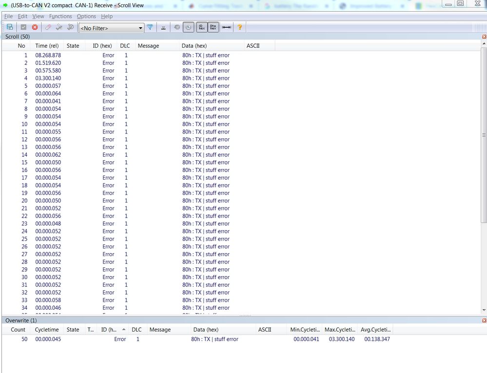

Even1
Hello:
    Has this problem been solved? I also encountered the same problem, there are no messages on the CAN bus, and the configuration is as follows:

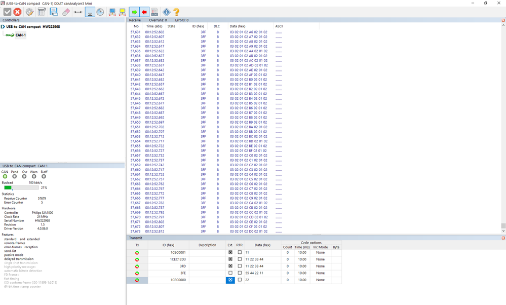

Hi guys.
I've just got same issue which was described. I tested the attached example and it was perfectly working on my DEVKIT-MPC5744P Board and I captured same data in CanAnalyzer3 like on screenshot. But when I changed Bit Rate to 500 Kbit/s, recompiled project and upload to board I saw that LED has been stopped blinking and there is no traffic on CAN bus. Is it bug in MBD or something wrong on hardware level? sshot-2019-07-01-[10-07-58].jpg

Hello ssuyakov@tae.com‌,
Could you share the generated code with us? And could you make sure you double-check the baud rate you've set in the USB-2-CAN application?

abhishek_kumar1
Dear Sergey
Is it possible that you did not change the BaudRate at Canalyzer 3 side.This is one reason to have an error.
