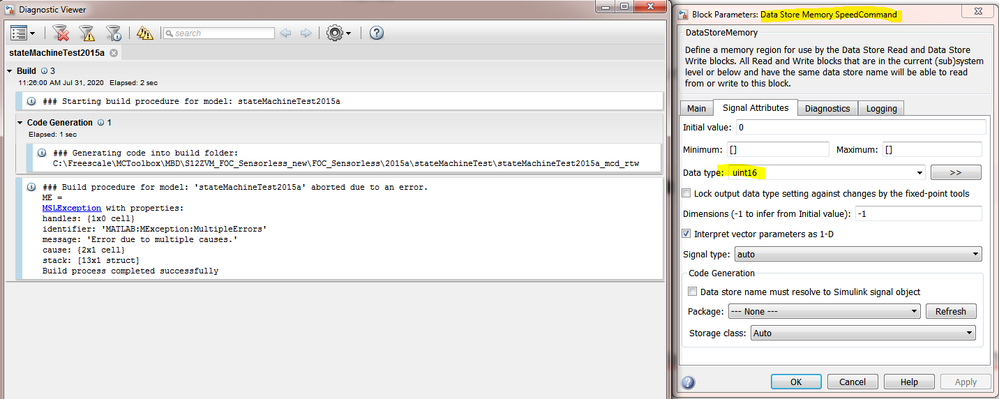

I tried to adapt the example model Model Based Design Approach to Motor Control with S32K144 - part No.1 from pachamatej to use with S12Z-evaluation board without success.
The environment:
matlab/Simulink 2015a
Motor Control Development Toolbox for MagniV S1... Version 1.3 (R2013a-R2015b)
Could you please take a look into the adapted model?

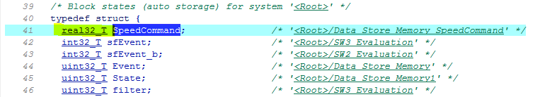

Somehow the variable SpeedCommand is declared as "float".
I want to change to "uint16" but then build error without any useful informations from Diagnostic Viewer.
Could you please try it by yourself ?
Many Thanks!
