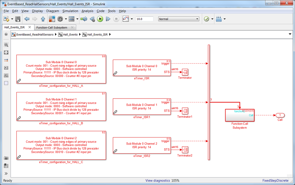

I can read the three Hall sensors just fine, but as I see in Freemaster, the HallChangeCount variable continuously increases, even if I do not rotate the motor (see screenshot). To be clear, the Hall_(A, B, C) inputs report correctly, but the count is always active. This eventually causes my board to crash after a short while. I know from the lecture videos, that this is not normal behavior.
I used both the original model file from the lecture 5 webpage (attached), as well as building the model from scratch following the videos.
Has anyone seen this behavior before? Is there a fix?

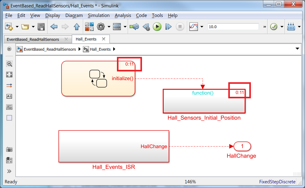

Now, coming back to your issue I think it is related to the order of block execution: check this topic - https://community.nxp.com/thread/449904#comment-899761
I've opened your model and i see that "Hall Sensors Initial Position block" is executed after "Hall Event ISR"
Please change the priority of the "Chart" to 1 and check if it works.

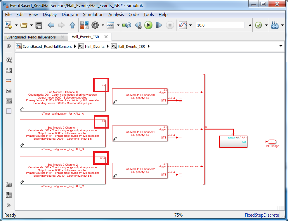

I've looked a little bit deeper in the model. For some unknown reason - MATLAB changed the execution order to the blocks (i do not understand why is that happening).
It generates the code for the ISR before eTIMER peripheric initialization code and cause the application to crash.
Please change the priority field of each blocks to look like this: eTimer configuration and then ISRs blocks

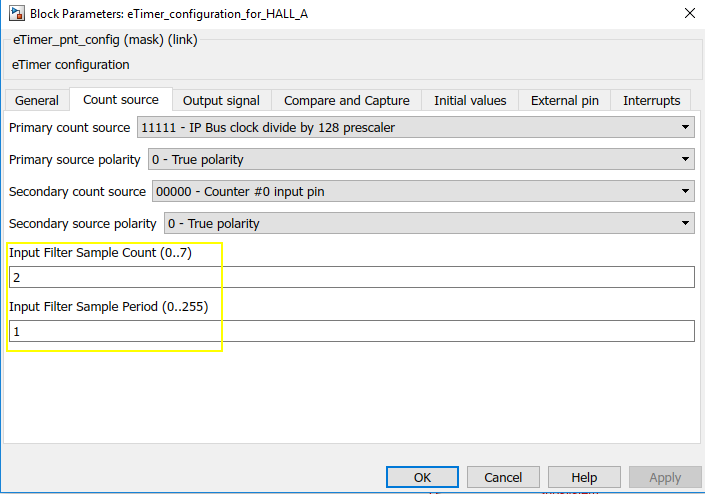

I think I found a solution though. Since it seems the problem is due to line noise, I enabled the eTimer input filtering mechanism:
Using these settings make the HallCount variable stable, and the system behaves like it should. This work-around should be acceptable, right?
Yes, it is the correct way to do it in case you're dealing with noisy signals. You might need to tweak the parameters until you get a good balance between reading delay and noise rejection.

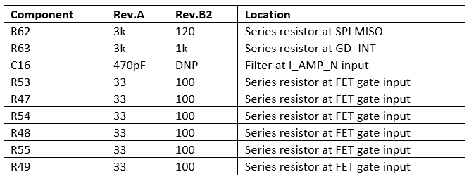

I used a rev. A of the Motor GD Development Kit. Between rev. B and rev. A there are a few modifications but nothing to interfere with HALL/ENC signals
Here is a diff between Rev A/B with electrical components changes.
Nonetheless, please do a simple test: unplug the hall signals from the sockets (maintain the +5 and GND connection over Motor GD JP1) and check with and oscilloscope if you have noise on the lines. If you do, then perhaps is due to your motor or 5v power supply.
