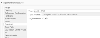

I hope this email finds you well. I am deploying an example project (MR-CANHUBK344 Can EBT from the MBDT in Simulink) onto my S32K344 board. However, this error message jumps out: " Error:Problem occured while downloading the application on target. Download aborted!" Please also refer to the photo attached to see the details of the error message in the Diagnostic Viewer. Could you please suggest what the issue is and what I could try to possibly solve the issue?

It seems that the download can't be performed because the JLink.exe file is stored at a different address on your machine, as compared to the one saved in the Hardware Settings of the model. By default, the model has the following address stored for the JLink.exe:
It is very likely that the SEGGER folder and related files are stored in a different location on your machine.
Please open the Hardware Settings window of the model, and on the Download menu, select the correct path for the JLink.exe. The download issue should no longer be present afterwards.
Please let me know if this solves your issue and if you need additional help.

Thanks @FlorinCiuca , the problem is solved following your advices! You are brilliant!
