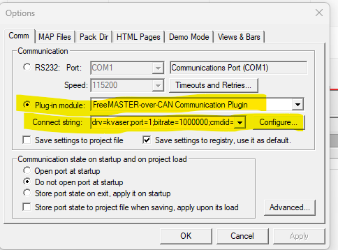

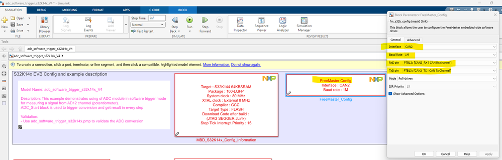

Was able to successfully flash & run code on to S32K144 MCU based ECU board directly out of Matlab-Simulink - NXP MBDT over Seggar Jlink. The code has the Freemaster Config Block over CAN2 at 1M Baud - Refer Image #1  Freemaster Block Config.pngFreemaster Block Config.pngimage.pngimage.pngimage.pngimage.png
Upon Opening Freemaster to enable the connection over CAN2 @1000K Baud , the tool detects my connected CAN2USB HW but the connection is not established.
  1. Is it because it checking for drivers in the location : C:\Windows\SYSTEM32\canlib32.dll where it cannot be found as this is greyed out for user to enter a different location. The latest Kavaser Driver for Windows is V5.44.630 but not sure it corresponds to the number 8.40.102.0 mentioned on the GUI
  2. Is it because the default command message ID & Response Message ID are the same at 0x7aa and need to be some other - could not find any such info in the Simulink config block to set
