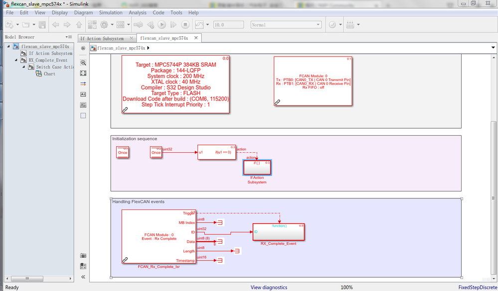

I open example model <flexcan_slave_mpc574x> to test FCAN Receive.When I want to get data from FCAN_Receive_ID_0x3FF,I click block parameters of FCAN_Receive_ID_0x3FF to selct Mode:blocking.Then occurs ERROR.Please Help!
Simulink model is attached.

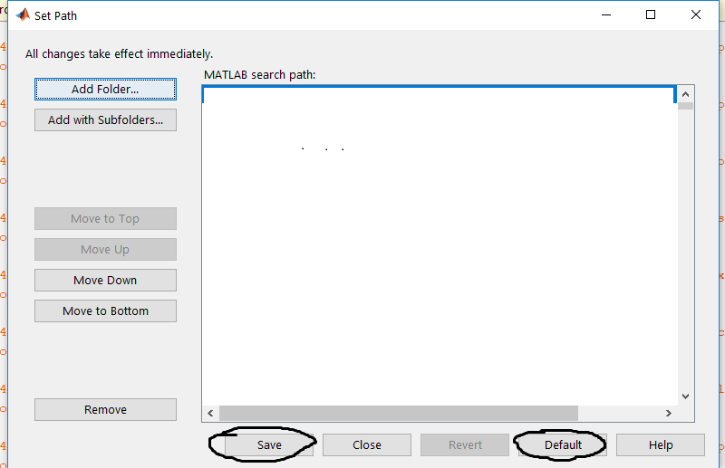

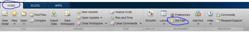

Can you try and reset the MATLAB path? For that you should go to MATLAB Home tab -> Set Path -> Click on Default -> Then click on Save.
and then run the mbd_mpc_path script so you install the path for the toolbox over a fresh, default MATLAB path.
Note: you will lose other paths other than the default + MPC toolbox paths by doing this. Consider saving the current  contents of your MATLAB path (you can get it by typing matlabpath in the MATLAB terminal for instance).
Note: this file is located in {INSTALL_ROOT}/src.
