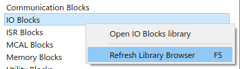

dragostoma
Hi, @XH,
Thank you for your interest into Model-Based Design Toolbox for S32K3.
First of all, what versions of MATLAB and Toolbox are you currently using? This way, we can try to reproduce your problem directly on your setup.
Until then, try reopening MATLAB and Simulink and refreshing the Simulink Library, by pressing F5 or by right-clicking on any section in the dropdown:
Keep us updated on your progress.
Dragos

XH
Hi @dragostoma
Thanks for your reply. The Matlab I use is 2024b, and the S32k3xx MBDT toolbox is Ver 1.5.0
After I refresh the tab "communication blocks", this window jumps out as shown in the attached photo.
Please advise what to try next
Many thanks,
Xiaomei
19,287件の閲覧回数
dragostoma
Hi, @XH,
Try the second option - "Generate repositories in memory" when you press the refresh button.
Keep in mind that the toolbox version 1.5.0 does not include support for MATLAB version 2024b. Therefore, you need to make sure that you run the path creation script (mbd_s32k3_path.m) to generate the codertarget folder corresponding to the version you are using (folder found at mbdtbx_s32k3|codertarget|2024b). If the folder exists but is empty, run the command mbd_s32k3.nxp.target.create_codertarget() to generate the folder contents. After that, make sure that this folder is in the MATLAB path. You should be able to use blocks by dragging and dropping them into a Simulink model.
