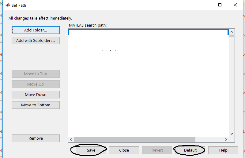

Hi dumitru-daniel.popa,
I have installed MBDT ver 3.0.0 and all the patches posted here (HotFix: MBD Toolbox rev3.0.0 for S32K ). However, when I try to build it and download to the board, I received the following error:
Could you please give me some suggestions? Thanks!
Code Generation 6 45
Elapsed: 28 sec

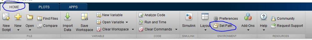

constantinrazva
Hello shaomuzhu‌,
From this type of errors
: >> C:\MBDToolbox\mbdtbx_S32K\S32_Platform_SDK\platform\drivers\src\clock\S32K1xx\clock_S32K1xx.h
COPY CATCH: Das System kann die angegebene Datei nicht finden.
it seems that there is a problem with the path - it does not find the files where the path points out so it can't copy them to the <model_name>_rtw folder, and from there the compilation process crashes (as it does not find those files).
Can you try and reset the MATLAB path? For that you should go to MATLAB Home tab -> Set Path -> Default -> Save.
and then run the mbd_s32k_path script again, so you install the path for the toolbox over a fresh, default MATLAB path.
Note: this will remove additional toolboxes path, so you'll have to add them back later.
Kind regards,
Razvan.
