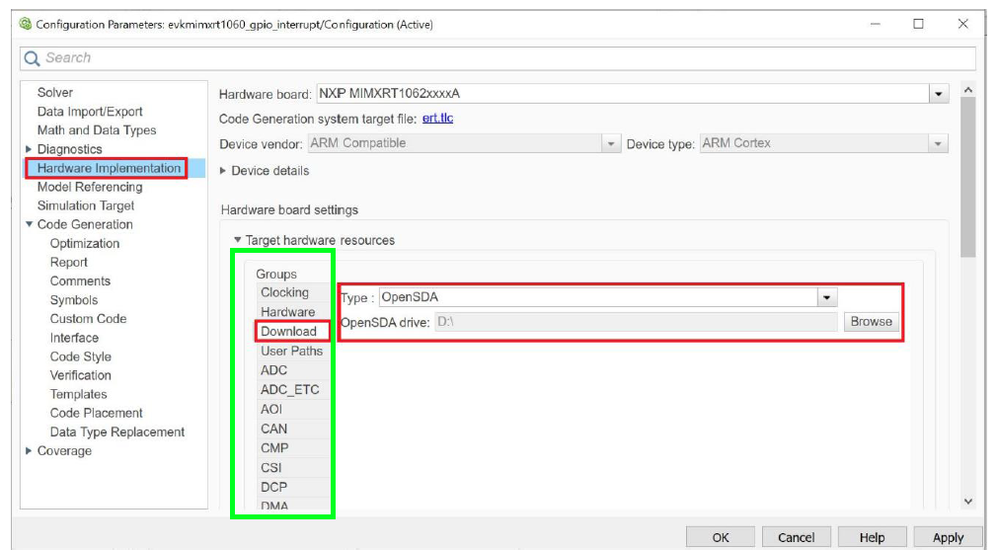

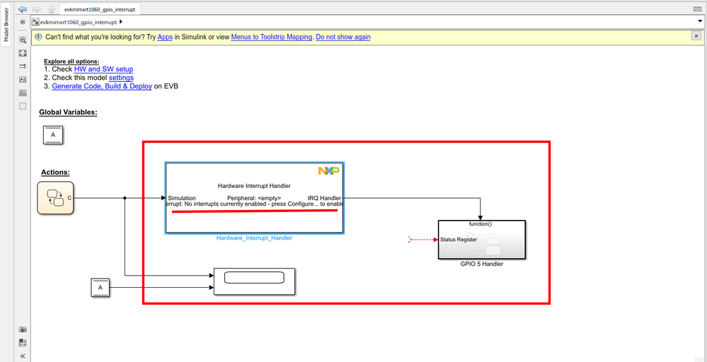

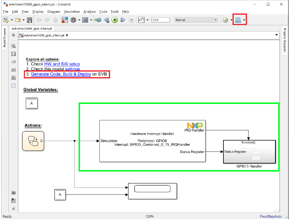

However, I notice some differences between what I have when I apply the tutorial steps and what I am  supposed to have.
On the one hand, here is the look of the example model in the NXP tutorial :
...here is mine :
Note the error message inside the "Hardware Interrupt Handler" block and the missing of the "Status Register" output...

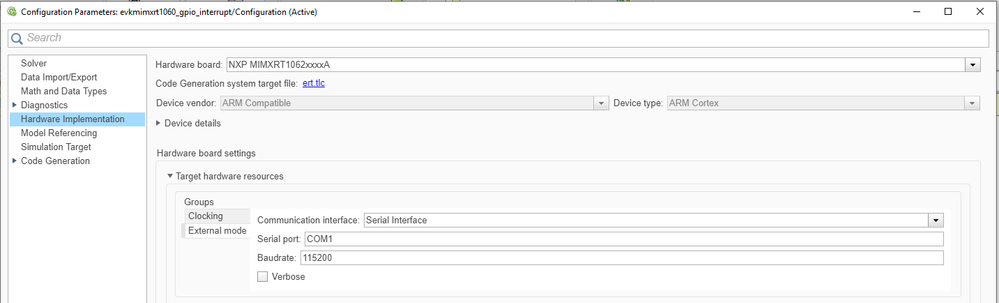

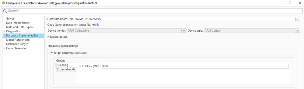

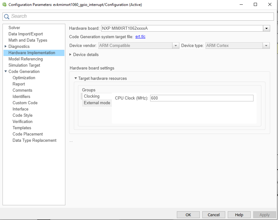

On the second hand, here is the "Hardware Implementation" settings in the NXP tutorial :
... and here is mine :
Note the missing of several groups in the "Target hardware resources" section...

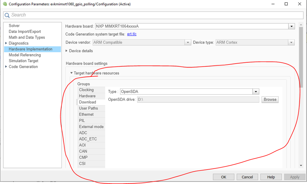

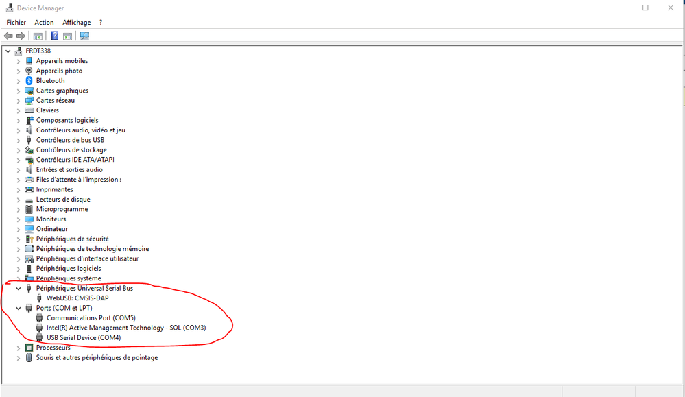

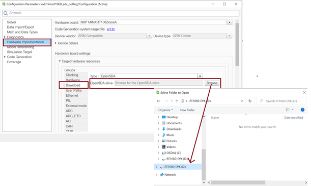

You don't need to install extras - did you run again the mbd_imxrt_path.m after you did the update in matlab preferences with datetime format? That will recreate the NXP targets - I suspect that the initial run of that script did not created correctly the targets so you need to run it again.
Also, when you plugin the board on your computer do you see a new drive appearing on your machine? like a USB mass storage device, named as the board, like in my screenshot above ? You can write the binary created from simulink: <model_name>.bin file also by just copy-paste it in the drive location.
BR,
Alexandra

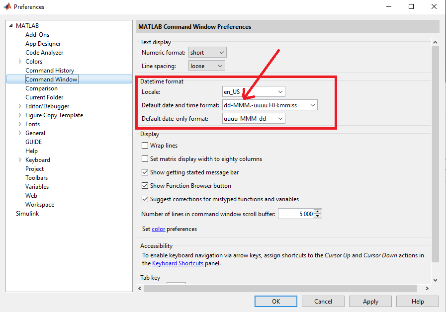

Hi Sebastian,
I looks to be a problem with the datetime format on your machine - the format that you have is not recognized by the Matlab. Maybe  @brianmckay has mode info here on the datetime call failure.
What are is the date and time format on your machine and also in Matlab preferences? Can you try to modify the matlab preference to have the next settings:

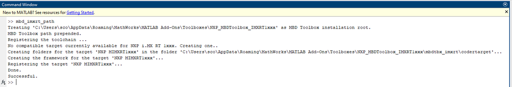

Restart the matlab, run again the mbd_imxrt_path.m script.
When you run the above script the first time, did you noticed similar error messages in the matlab command window?

Hi Alexandra,
Thank you very much for your help !
After having update our Matlab date/time fomat, all errors have disappeared.
In addition to your advice, we have to add a dot character after the month format (MMM) because in the error message, the date/time was in this following format :
Could not recognize the date/time format of '11-oct.-2020 21:38:18'.
So our new settings are :
Thanks to that settings (and you ;-), now the NXP example model is correctly loaded into Simulink and also successfully built !

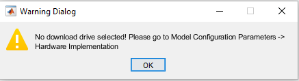

Now we try to upload the application in the evaluation kit but we have the following warning message :
Next to this message, nothing happens... the target is not updating with the generated code.
Please, have you any idea ?

You need to go to Hardware Settings, under Hardware Implementation -> Target Settings-> Download -> Browse for OpenSDA drive:
BR,
Alexandra

In Hardware Implementation settings, there is no "Download" group as it is shown on your screenshot.
Here are my settings :
As you can see, I have only 2 groups : Clocking & External mode...
Do I need to install a specific software to have "Download" group ?
Here is my Windows Device Manager settings :

nxa11767
BR,
Alexandra

I just uninstall Toolbox in order to start again with fresh NXP install.
After re-installing, I have checked Date/time settings and they were OK.
So, I ran the mbd_imxrt_path.m script and the output was successful :
Then, I have opened the NXP example model and set download settings as you mentioned :
I have launched "Build" and voila
The target has been correctly uploaded in the evaluation kit and the program works perfectly !!!
Thank you very much for your support. It was very nice.
