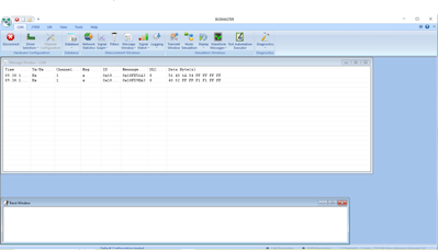

1. Ok, you  are  able to receive CAN messages using both Can Controllers (CAN 0 & CAN 2) and both Can Hardware Objects. This is also visible in the screenshot you provided: there are two CAN messages in Busmaster with Rx under Tx/Rx column. This means that you are able to transmit CAN messages from your custom board to the PC Busmaster using both CanController0 and CanController2.
At this point both transceivers are working correctly
2.  What does it mean "we can't be able to read into bus master"? Doesn't this afirmation contradict point 1. and the attached picture from point 1. ?
Are you trying to send can messages from CanController0 to CanController2, of the same, board while also monitoring the bus with BusMASTER?
Are there any other nodes connected to this CAN bus that send and receive messasges?
