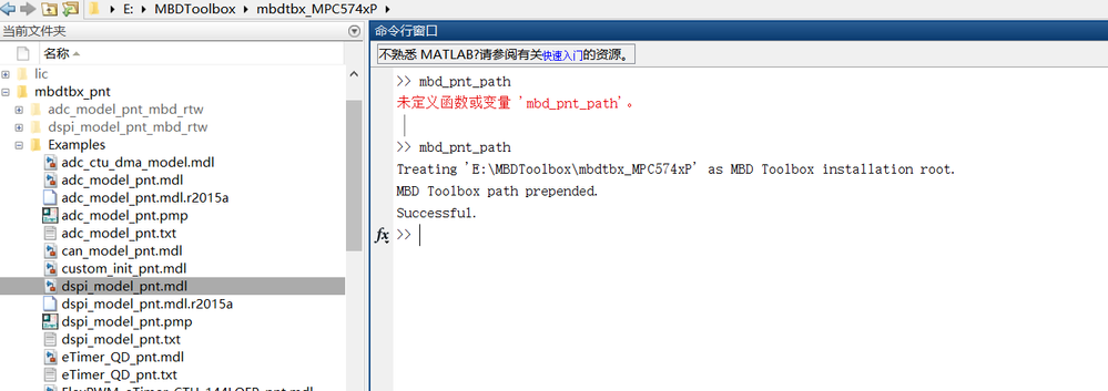

Hello dear all,
I have installed the MBD Toolbox and also run the mbd_pnt_path.m, but I can't see the MBDT block in simulink, somebody knows why? Thank you~

I meet the same problem with you. Do you have solved the problem?
I use matlab 2016B x 64bit in Win10 professional  x 64bit. I have install mbdtbx_MPC574xP, but there is no MBDT block while opening simulink library.  It doesnot work even if I try to press F5.
I hava run the following step referencing to Setting the Path for Model Based Design Toolbox.

It fix now after I re-install the matlab and MBDT.

I presume that pressing F5 (refresh) while Simulink library is open does not work.
What is the Matlab version you are using ?

refresh does not works, my matlab version is R2015b. Thank you

That's really strange. I've using the same setup without any issue. It's true that i do not have so many toolboxes but i think that could be a Matlab issue.
Here is what i've found out on Mathworks website: Simulink Library Browser doesn´t show any blocks - MATLAB Answers - MATLAB Central
Perhaps some of those answers will help you make it work.
