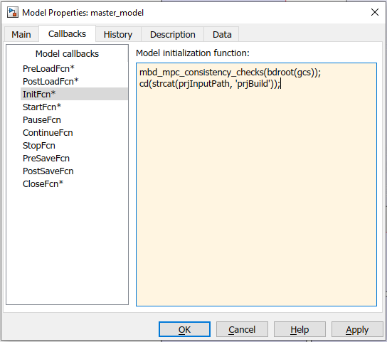

Hello I have a simple issue that I couldn't find any workaround for it. Any line of code I add to the InitFcn Callback - before or after - gets deleted once I simulate or generate code and just leaves behind the line "mbd_mpc_consistency_checks(bdroot(gcs));".
The line of code is simple as well, as shown in the screenshot below.
If anybody came across such thing that would be great help.
Thank you.

Hello @mazzinsherif ,
Sorry for answering you so late. This is a behaviour we have noticed as well, and in order to avoid this, you have to replace the attached p file.
To do so, please type in the matlab Command Window the following command:
winopen(fullfile(mbd_find_mpc_root, 'mbdtbx_mpc','mscripts','config'))
This will open Windows Explore, whre you have to replace the mbd_mpc_set_tmf.
Hope this helps,
