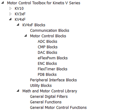

Hello dumitru-daniel.popa
The Simulink blocks keeps a similar look-and-feel, but there might be different options due to IP differences.
the KV4x library also has a "FTM_Three_Phase Output" block.
So could you explain why I should use FTM_Three_Phase_Output or eFlexPWM_Three_Phase_Output ?
There is the FreeMASTER Config block, which I can't find in the KV4x library.
The Freemaster block implemented in S32K is brand new and contains enhancements what are only available on S32K products (and for all future releases)
In the old versions we will not find all these option.
Nonetheless, you can modify the behavior by hand. If you go to ..\mctbx_Kinetis\mctbx_kv\src\FreeMaster_files you will find a file freemaster_cfg.h that is copied into the generated folder. You can change this file to configure the FreeMASTER to use RECORDER and INTERRUPTS.

Daniel_Popa
Hi Leon,
Even if Kinetis and S32K microprocessors share the same ARM Core and similar peripherals - they belongs to tow different toolboxes that complicates the things. In this case there are 2 different SDKs with different drivers and initialization structures that are used to generate the code. If you check the TLC associated with each of the block you will see those differences:
Therefore, as general rule - use only the Simulink blocks that are exposed by each Toolbox Simulink Library: if you use a Kinetis microprocessor then use only the ones from Kinetis V Series Simulink Toolbox
So I have to use the „freemaster_data_recorder“ Block found in the kv4x Library instead of your S32K „freemaster_recorder_call“ in the "Fast Loop Control" Subsystem ?
Yes, you have to use the one from KV4x Library
What exactly I have to Change in the "freemaster_cfg.h" file ?
That is simple
Keep in mind that FreeMASTER can work on any kind of embedded applications not only the ones generated by Simulink. All we do in Simulink block is to change the defines in the freemaster_cfg.h file
For KV4 this is not done - is it just copied from default location into the generated file. For your reference, i've attached the file used in the M5 module. You can see compare it with your file and change the defines that you need.

Daniel_Popa
Hi Leon,
In your original Module5 model you didn't have activated Freemaster in the s32k_config
I'm using the S32K toolbox revision 3.0.0 which has a dedicated FreeMASTER configuration block.
if I use the „freemaster_data_recorder“ from Kv4x library or should I activate Freemaster also in the MCD_MKV4x config block like below ?
For KV4 you have to use the FreeMASTER configuration from the main configuration block as you have shown above.
