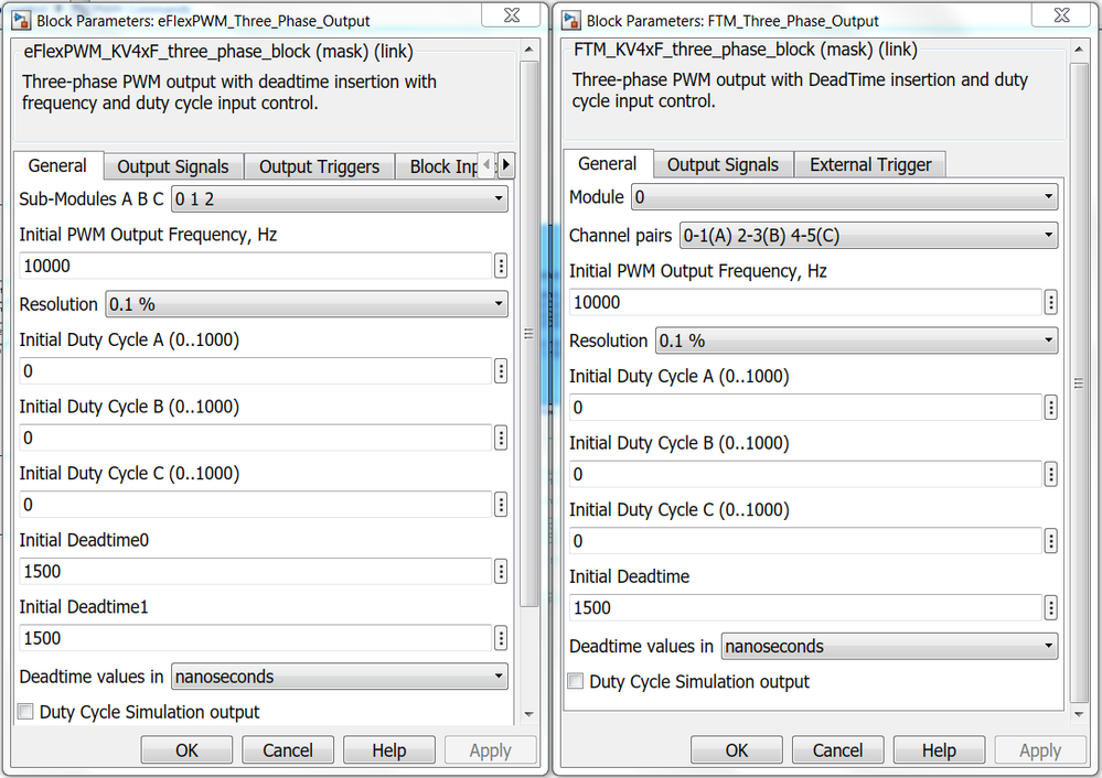

Hello dumitru-daniel.popa
The Simulink blocks keeps a similar look-and-feel, but there might be different options due to IP differences.
the KV4x library also has a "FTM_Three_Phase Output" block.
So could you explain why I should use FTM_Three_Phase_Output or eFlexPWM_Three_Phase_Output ?
There is the FreeMASTER Config block, which I can't find in the KV4x library.
The Freemaster block implemented in S32K is brand new and contains enhancements what are only available on S32K products (and for all future releases)
In the old versions we will not find all these option.

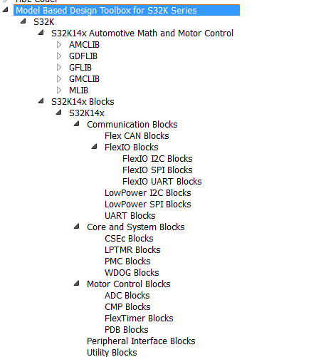

Even if Kinetis and S32K microprocessors share the same ARM Core and similar peripherals - they belongs to tow different toolboxes that complicates the things. In this case there are 2 different SDKs with different drivers and initialization structures that are used to generate the code. If you check the TLC associated with each of the block you will see those differences:
Therefore, as general rule - use only the Simulink blocks that are exposed by each Toolbox Simulink Library: if you use a Kinetis microprocessor then use only the ones from Kinetis V Series Simulink Toolbox
So I have to use the „freemaster_data_recorder“ Block found in the kv4x Library instead of your S32K „freemaster_recorder_call“ in the "Fast Loop Control" Subsystem ?
Yes, you have to use the one from KV4x Library
