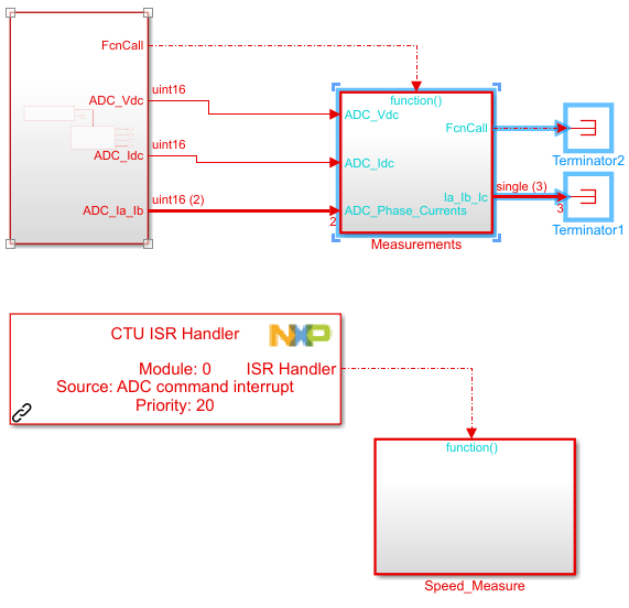

Hello,community
The CTU is configured to trigger the ADC conversions when the flexPWM reloads。
At the same time,I set the adc command interrupt to toggle the led.
but  it is failure due to an error. matlab ver:2019b,MBD ver:3.20;
Can you help me to solve it?
In addition , the ADC conversions frequency is the same as to flexpwm.
How do I set up the CTU module If I want to convert some ADC signal at a low sampling frequency?
Any suggestions will be appreciated.
 best regards
hao
2,751件の閲覧回数
mariuslucianand
Hello [email protected]‌,
This looks like a compile error. The variable test1_extcal_IN_A1 has not been found in the CTU interrupt file. One of the way in which this can be solved is to right click of the s-function called by the CTU interrupt block, go to Block Parameters: Subsystem and select reusable function in the Code Generation tab.
Hope this helps,
Marius
Hope this helps,
Marius
2,751件の閲覧回数
haoxue1027
Contributor V
Hello,Marius
I have set it as you commanded , and it worked. No errors happened.
Thank you so much for your assistance.
It helps a lot.
By the way, the ADC conversions frequency is the same as to flexpwm above.
By the PIT or Etimer module or other methods?
