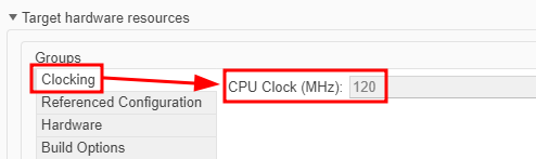

IN CLOCKING OPTION (UNDER HARDWARE SETTINGS ) I AM HAVING 0 MHZ , BUT I HAVE CONFIGURED IT TO S32K312 BOARD

Hi, @paul_ephraim_13,
The problem you are facing seems to be caused by the non-compliant setting of the configuration project. In the Hardware tab you will find the link from the Configuration Template section, make sure it points to the correct configuration project.
After you correctly set the path to the configuration project, the frequency of 120 Mhz should be displayed correctly. Let us know how the check went.
