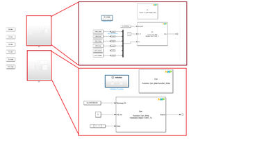

Both controllers are initialized in the model, and the Tx blocks are set up identically for both. I’ve attached the .mex file for reference, along with a screenshot of how I'm configuring the blocks in MBDT.

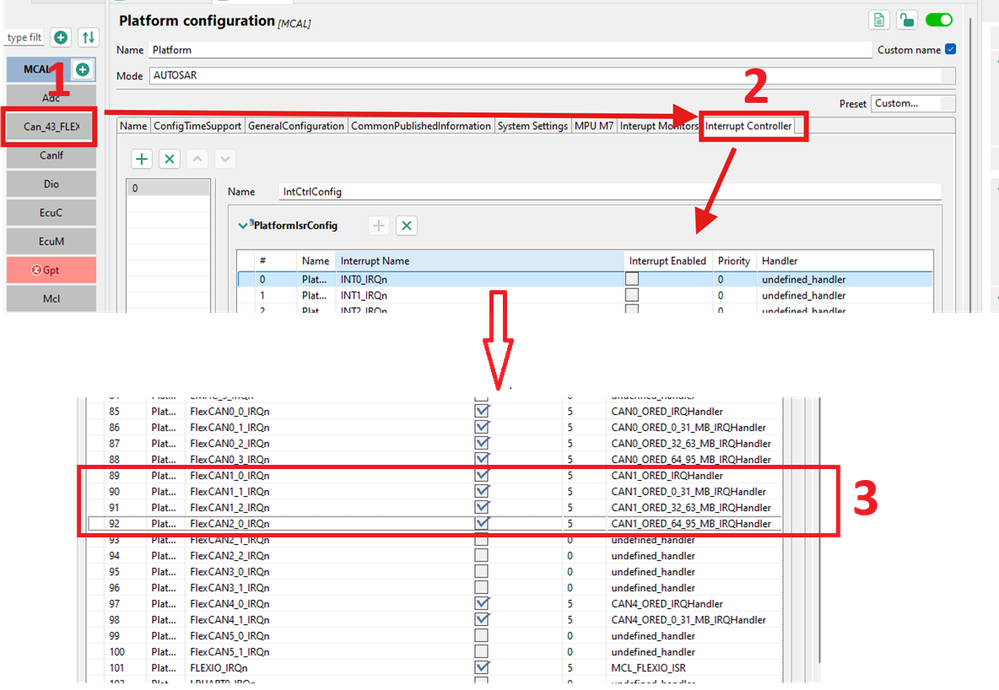

1. In the platform configuration, you need to enable the interrupts for the FlexCAN component, set a priority and add the IRQ handlers.. The lower the number, the higher the priority.

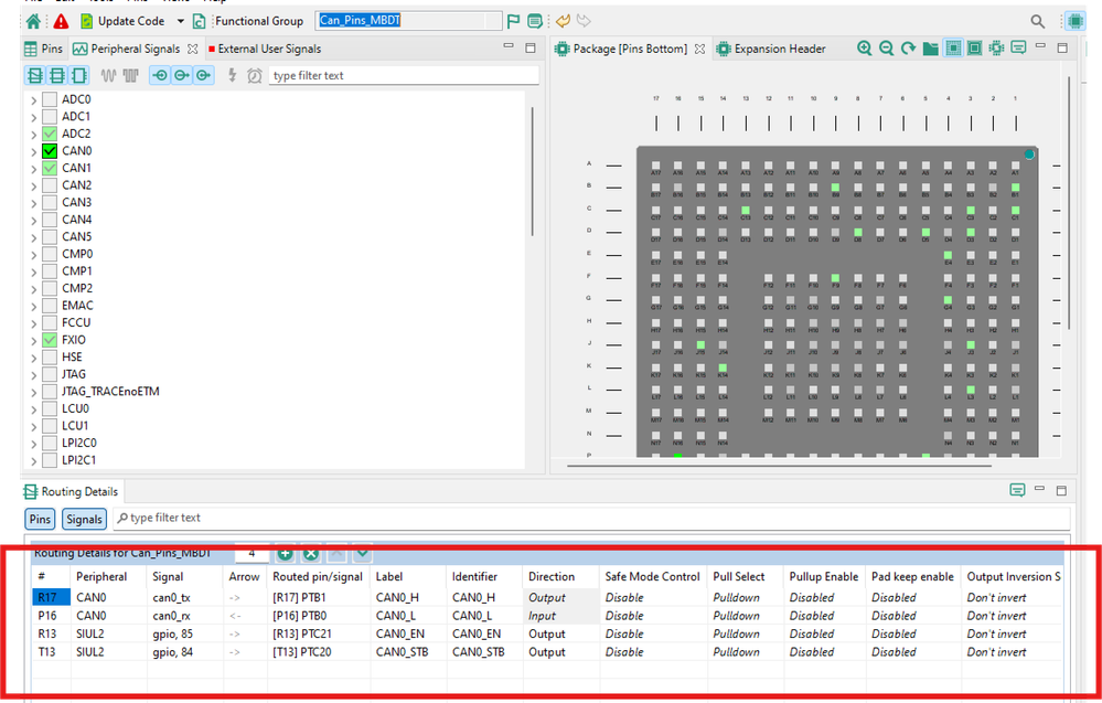

2. You need to configure the pins in the PORT components for the CAN instance you want to use, similarly to the CAN0 instance.
3. In the PINS view, you need to configure the EN and STB pins for the transceiver too, similarly to the CAN0. If the state of the EN and STB are not properly set, you might get undefined behavior.
3.1 If you want to control EN and STB at runtime, you also have to update the DIO component with the EN and STB pins, similarly to CAN0.

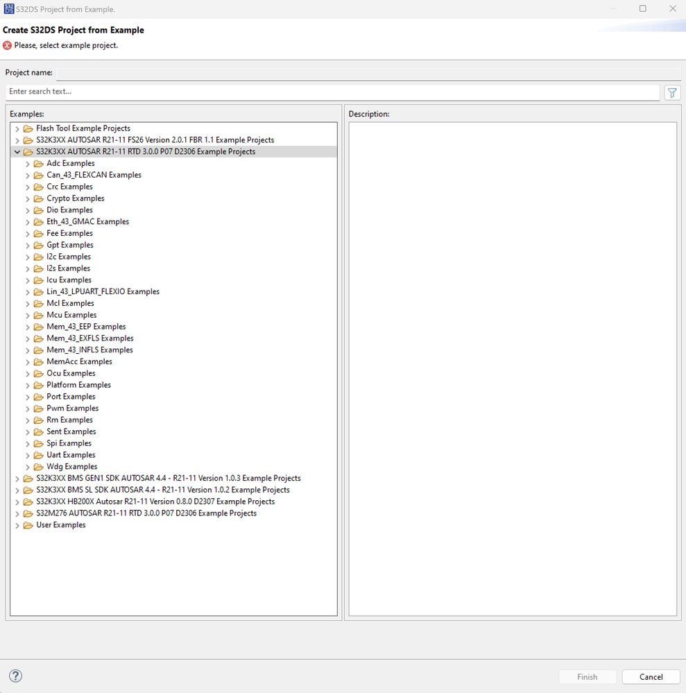

If you want to see how to configure, initialize and use different peripherals, you can install S32 Design Studio and install the same RTD version as the RTD included in the toolbox.  Then, you gain access to examples for most of the peripherals (including configuration projects .mex).

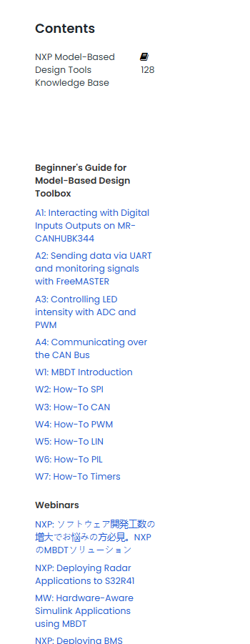

Another way to understand the MBDT workflow is to check the webinars and articles available on the MBDT Community.

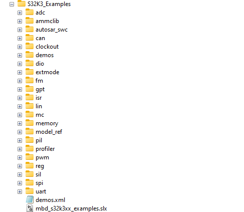

The third option is to check the included examples in the MBD Toolboxes.  All the supported peripherals include at least one example to showcase the functionality.
