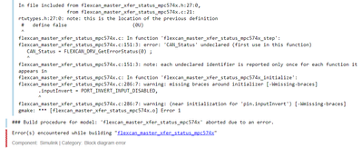

hbhnhbnhj1
Hi @mariuslucianand @PetrS @adriantudor
I add the modified custom code to CAN example code and try to build it.
However, the build is failed, the end of result is shown in figure below.
Detailed build result is attached as【flexcan_master_xfer_status_mpc574x_build_20220420_125122.txt】, and the test code is attached as【flexcan_master_xfer_status_mpc574x.zip】.
Please help me solve this problem, thank you.
