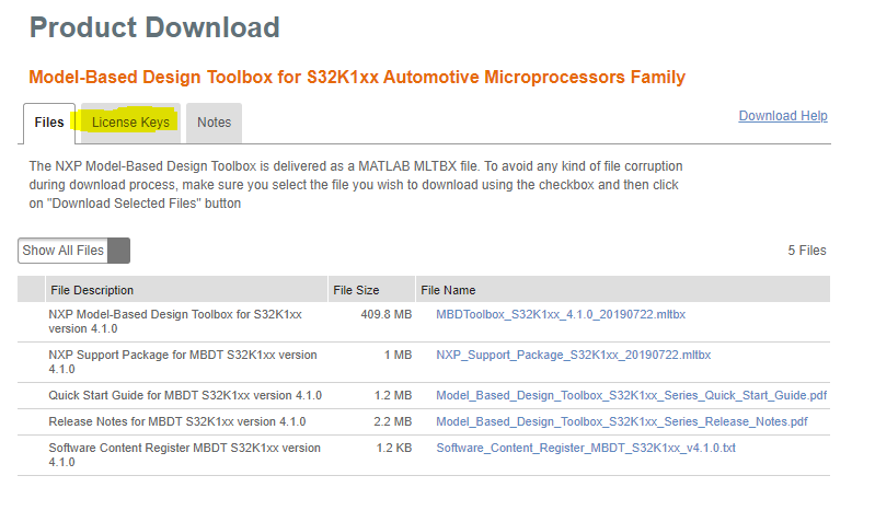

In order to use our MBDT blocks you need to get a free license form the NXP's website using the HostID mentioned in the error message. To do so, please go to https://nxp.flexnetoperations.com/control/frse/product?entitlementId=231620027&lineNum=1&authContact... this page, select the toolbox you need, read our terms and select the License Keys tabs. Press generate and follow the procedure.

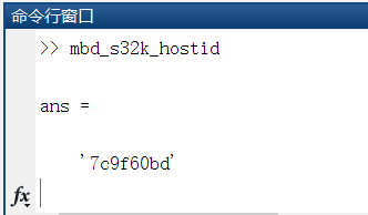

Hello Marius,
1.Here is the serial number of my HOST ID;

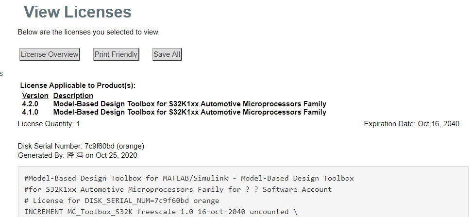

2.This is my license;

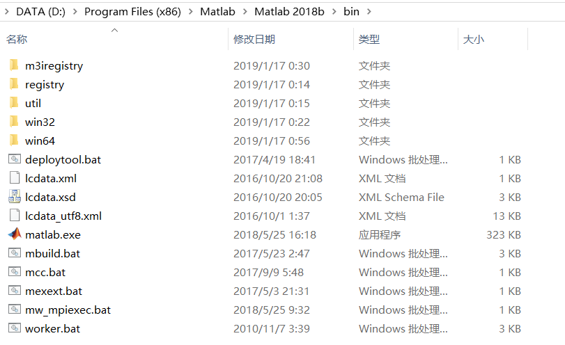

3.This is my MATLAB installation location;

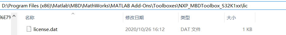

4.This is where S32K-MBDtoolbox and license are located;

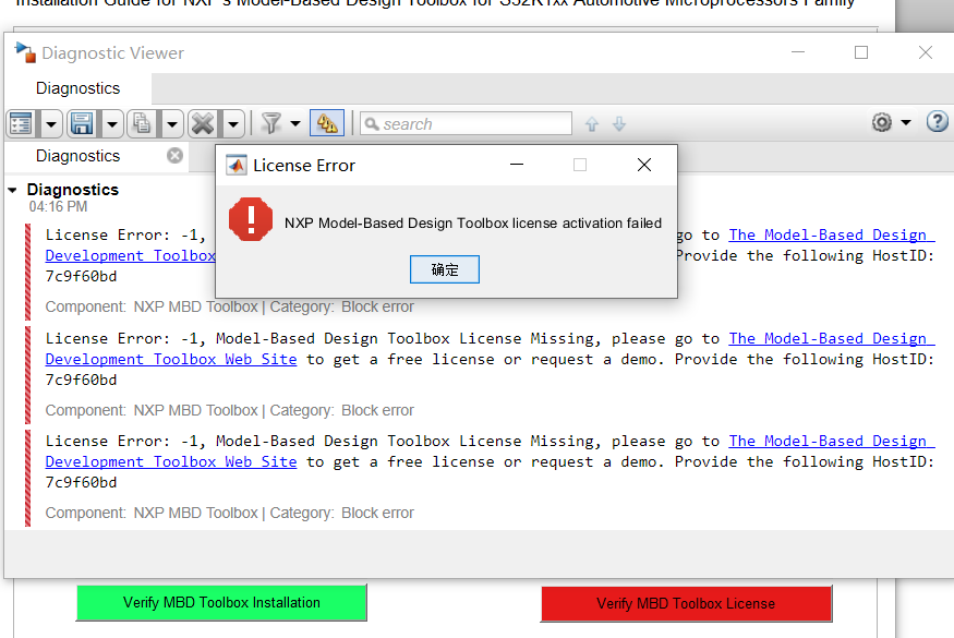

Can you please rename the extension from .dat to .lic?

My problem should appear on the installation path of MATLAB. After modifying the path of MATLAB, the problem has been solved.
