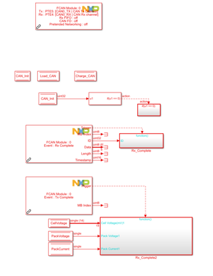

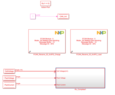

I basically used the BMS example and read the voltage and current values. What I want to do is broadcast these information via CAN. I want to broadcast these values continuously and start from CAN example projects and used an initialization block, RX complete block, TX block and main configuration block.

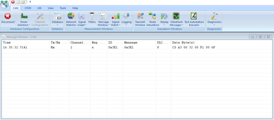

When I use a Kvaser usb to CAN converter and try to observe CAN messages in Busmaster I could only observe one message, the other messages did not appear in the messages. What might be the problem and how can I solve this problem? The screenshots are provided below, somehow I could not attach the model but I can also send the simulink model.

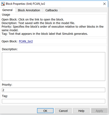

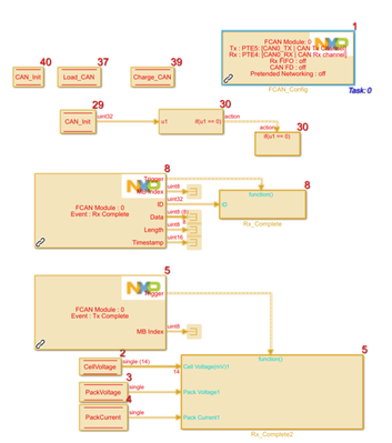

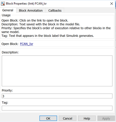

First of all I use J16 pin as power source and priority of CAN blocks of FCAN_Config, TX complete, and RX complete are 1, 2, and 3 respectively. Also you can see execution order as follow.
I try you attach the zip file of the model in here but I could not do it I do not know why. I shared the screenshots here and send the model via  mail. Please not that I want to broadcast as much information (cell voltages, pack voltage, pack current, temperatures etc) as possible continuously and receive few messages over CAN in order to determine the mode of operation  (i.e. Load or Charge).
