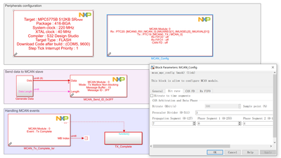

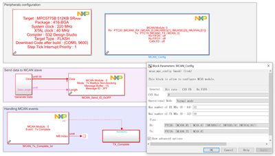

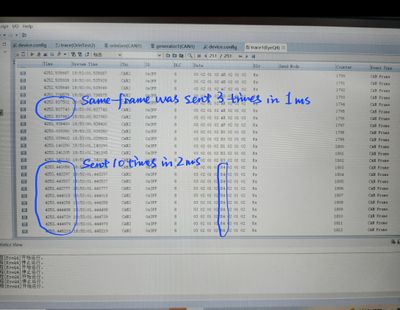

1. When I used the example program to set up the CAN sending node, I found that the message would be sent repeatedly: the running period of my MCAN_SEND module was 0.1s, but when I used the CAN analysis software to receive it, I found that the MCU would send the same frame of message repeatedly several times in a very short time, and the time difference between the messages with different contents was about 0.1s, which is correct.  Does anyone know why that is? What's the solution?
2. Under the same Settings, MCAN0 can successfully send and receive packets, but MCAN1 cannot send and receive frames normally. I noticed that MCAN0 and MCAN1 use different transceivers, MCAN0 uses TJA1045T/FD, which is driven by DSPI, does it require special Settings?
Here are my Settings:
RegulusCheng_0-1687259940722.pngRegulusCheng_0-1687259940722.pngRegulusCheng_1-1687259970125.pngRegulusCheng_1-1687259970125.png
and here are the frames I received from the CAN analyzer:
