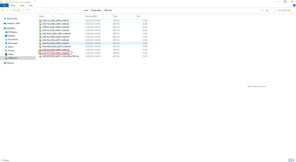

 1. The RBF file needs to be flashed first on the board so that just after the processor boots up, the bootloader is ready to accept the new image. For more details, please have a look on this thread: https://community.nxp.com/t5/S32-Design-Studio/undefined-reference-to-START-BSS-and-others/m-p/12764...
In MBDT you could find the .rbf files in here:

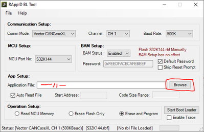

3. In order to write the new application over can, this has to be done from the RAppID BL Tool, which could be downloaded from the NXP website. Here, the Vector CAN probe and channel need to be specified and for the S32K14x some of the settings below need to be set. Of course, the .mot file location needs to be specified. You have to press the reset button on the board, and immediately to press the Start Boot Loader inside the RAppID BL Tool.
