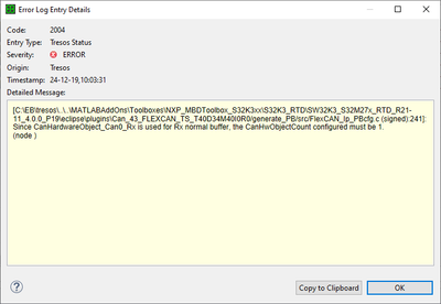

This seems to work well with TX messages, but not with RX messages as I am getting the next error at Tresos.
So according to that description, "Can Hw Object Count" must be set to 1, which was the original config I had. The problem is with that config I didn't receive messages at all, I assume because the message buffer is limited to a single message.

Hello AsierMaser,
Each Tx message requires a dedicated hardware buffer because transmission is an active process where the controller must ensure message arbitration, timing, and retransmission if necessary.
The CanHwardwareObject is the description of the physical CAN message buffer used for transmission and you can have more than one instance of this description based on the needs of your application.
The CAN HW Object Count for Tx specifies the number of dedicated Tx hardware message buffers (instances of CanHwardwareObject) needed for outgoing messages.
For normal Rx objects, CAN controllers use a filtering mechanism to direct incoming messages to a common buffer or directly to software, rather than requiring a dedicated hardware buffer for each Rx message.
This reduces hardware complexity, as incoming messages are typically processed and stored in software-managed queues in your application.
The filtering mechanism from each CanHwardwareObject must be optimally set so that the load on each message buffer can be handled correctly and on time. This eliminates the need for having more than one instance of the CanHwardwareObject (message buffer). For this reason CAN HW Object Count for Rx objects can only be 1.

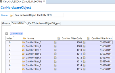

Adrian_Gherca
It is mandatory for a CanHardwareObject to have at least one CanHwFilter with mask and filtering code configured. These two are important for defining which messages the Rx buffer accepts.
If you haven't configured them but still receive CAN messages, then it might be the case that the Filters Mask of each Receive CanHardwareObject is set to ignore all bits of the Filter Code (Filter Mask=0) which leads to accepting all incoming message IDs.

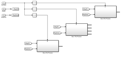

I am not sure about CanIf_RxIndication. When I configure the ISR block there is an option for transmit messages (CanIf_TxConfirmation) and another for receive messages (CanIf_RxIndication). Is this statement wrong?
My thinking was that as soon as a message is received the CanIf_RxIndication would trigger the ISR and depending on the HW object ID I could know which bus caused the interruption. Then I could handle the data inside the corresponding block, as seen in my previous post images.

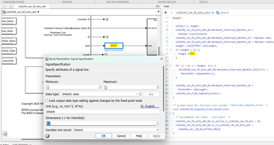

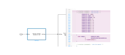

I noticed that the received data was always on the first byte of the messages, so analyzing the generated code this is what I saw.
So first the Data array is cleared and then a memory copy is done to that array, from the data obtained in the interruption handler. The problem here is that even the message's payload is 8, just 1 byte is copied to the data array.
After that I checked the interruption handler, and this is what I got.
As you can see at line 236, there is an if that limits the payload of the data to 1 byte. Now my question is, why is this happening? It may be a config error, but I am sure that I defined the payload to 8 on the Can_43_FLEXCAN driver.
7,638件の閲覧回数
Adrian_Gherca

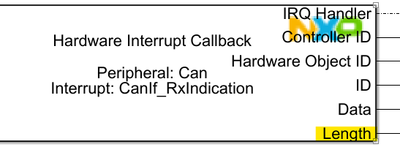

What you are highlighting at line 236 is an important clue.
That value to which the variable "length" is compared, represents the size of the 4th output of the CanIf_RxIndication Interrupt Callback block.
In this case, it looks like the size of the "Data" is 1, which means that only one byte of data is transferred through that output.
To fix this. I suggest that you have a look at the s32k344_can_fd_echo_ebt example from the toolbox:

AsierMaser
Hello Adrian,
It did work! Now messages are receiving correctly and the bus management is working fine.

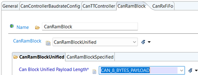

However there is something I don't really understand. IRQ handler takes the data from CAN MB every time RX reception flag is set. This CAN data size is configured in Tresos to be 8 bytes, and given that IRQ itself has no data or size, how is it possible to just take a single byte unless you specify the correct legnth of the data (which is already configured in Tresos)?
Thanks for your support,
7,531件の閲覧回数
Adrian_Gherca
If you are referring to this EBtreos setting:
Screenshot 2025-02-03 160937.png ,
this is the size of the memory area allocated for the Rx message buffer. This does not reflect the actual data size of the incoming CAN messages, it acts more like an upper limit.
You can extract the actual data length of the CAN message using the 5th output port of the CanIf_RxIndication Interrupt Callback block:
