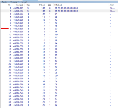

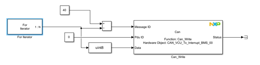

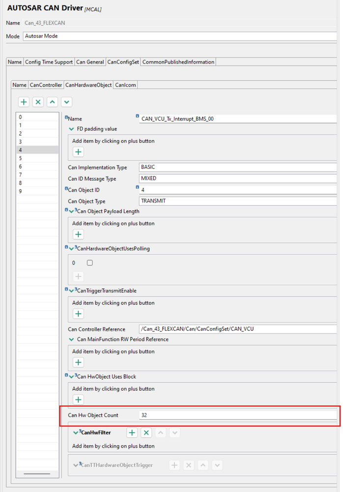

I've tested on a S32K358 HVBMS reference design the following scenario:
  • Use a single TX Hardware Object and set the Can Hw Object Count to 32 (to allow a maximum of 32 messages in the buffer).
  • In Simulink, I populated the message buffer with 32 messages, increasing the priority as it populates the buffer, to prove the arbitration process.SorinIBancila_3-1751891054922.png
The results:
As expected, the first messages sent are with low priority, as the message buffer is not completely populated. Around the 6th message, the buffer is populated and we can see that the messages with higher priority are sent first.
Since you want to use a single transceiver, it is not really possible to simultaneously send all the messages at the same time.

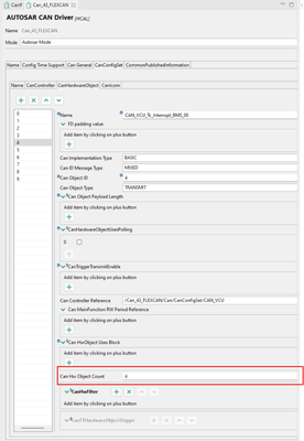

SorinIBancila
The 32 Can Hw Object Count is not the limit. You can increase the limit even further, depending on what MCU you have. You can modify the number of Can Hw Object Count and if you put a number too large, the S32CT is going to throw an error.
