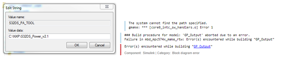

I have MATLAB 2018b.
I installed Design Studio for Power 2.1 and suddenly Simulink file do not build anymore
I changed the registry value (below)
 I have attached the error and build file.

There are some differences in the folder structure, between the S32DS for PA 2.1 vs 2017.R1, so, in order to build using the compiler from S32DS V2.1, the following changes must be performed:
   1. S32DS_PA_TOOL must be set as path variable as 'C:\NXP\S32DS_Power_v2.1'
   2. the .tmf file from src\mbdtbx_mpc574x\mbdtbx_mpc574x location must be updated with the one attach.
