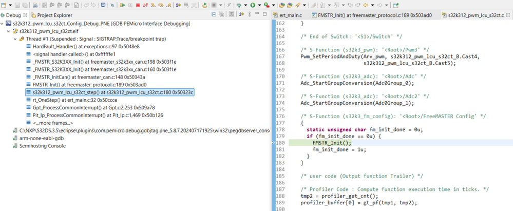

Regarding your attached project, i have tried to build and run on my S32K312EVB but it goes to a Hard Fault:
It seems to be a problem with the FreeMASTER over CAN.
Can you send me the latest working project ?

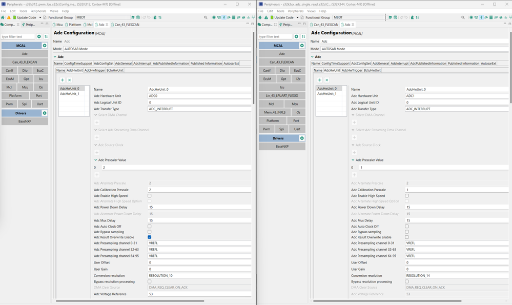

Here you can open the two instances of S32 Configuration Tools from C:\MathWorks\Toolboxes\NXP_MBDToolbox_S32K3xx_150\tools\S32ConfigTools.2024.R1.7\tools.exe
Then you can compare the two configurations side by side:
I will recommend to use the settings from s32k3xx_adc_single_read_s32ct.mdl and modify them in your configuration.

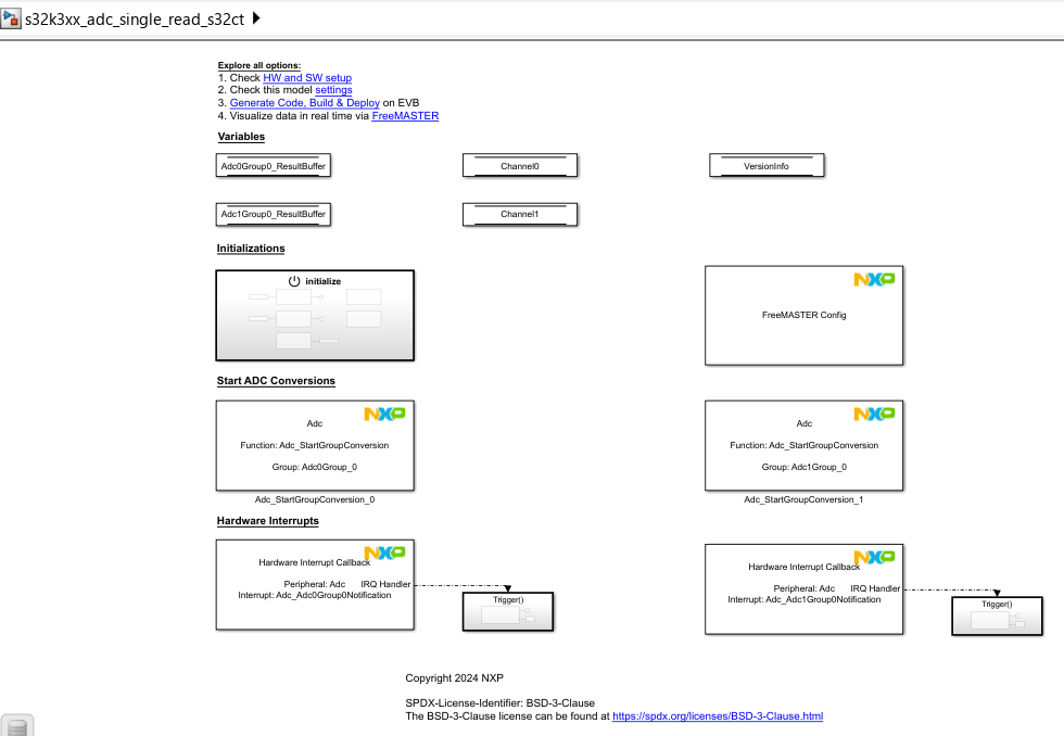

Also i saw in your model , that you are not using Hardware Interrupts for the ADC reading functions:
So let me know how the ADC works after you test your model with the settings from s32k3xx_adc_single_read_s32ct.mdl,
And send your the latest working model, not the one that goes into Hard Fault.
