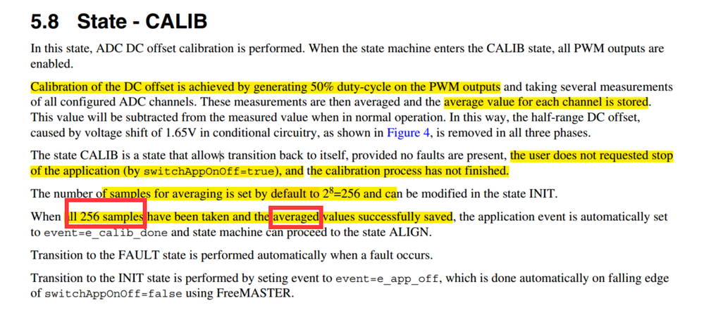

A C-code segment in the main.c shown as below:
tBool ADC_ModuleCalib(pmsmDrive_t *ptr)
static tFloat fltFiltOutput;
if (!(ptr->adc.flag.B.calibInitDone))
ptr->adc.calibCntr = 4096; // 2^(8 + 4) order to accommodate settling time of the filter
ptr->adc.measured.fltPhA.filt = 0.0F;
ptr->adc.measured.fltPhB.filt = 0.0F;
ptr->adc.measured.fltPhC.filt = 0.0F;
ptr->adc.measured.fltUdcb.filt = 0.0F;
ptr->adc.flag.B.calibDone = 0;
ptr->adc.flag.B.calibInitDone = 1;// initial setup for DC offset calibration done
if (!(ptr->adc.flag.B.calibDone))
* Phase A - DC offset data filtering using MA recursive filter
* filt= filtered value
PART A:
ptr->adc.measured.fltPhA.filt = MLIB_Add(ptr->adc.measured.fltPhA.filt , ptr->adc.measured.fltPhA.raw);
fltFiltOutput = MLIB_Div(ptr->adc.measured.fltPhA.filt,ptr->adc.param.u16CalibSamples);
ptr->adc.measured.fltPhA.filt = MLIB_Sub(ptr->adc.measured.fltPhA.filt,fltFiltOutput);
ptr->adc.offset[ptr->svmSector].fltPhA = fltFiltOutput;
if ((--ptr->adc.calibCntr)<=0)
ptr->adc.flag.B.calibDone = 1; // end of DC offset calibration
return (ptr->adc.flag.B.calibDone);
Analysis:
  According to the C-code segment,we can conclude that in the ADC_ModuleCalib() function ,will execute 4096 cycles in the ADC_ModuleCalib() funtion, then jump out the ADC_ModuleCalib().
The Value of u16CalibSamples is defined 256 in the stateInit().
The reference AN4518:
question:
1#,Why we assign the 4096 to ptr->adc.calibCntr,rather than  ptr->adc.calibCntr=.u16CalibSamples?
I thought we should sum the ptr->adc.measured.fltPhA.raw,and then averaged the values,that is the sum divide u16CalibSamples.
2#,I seemly not cleary with the Phase A - DC offset data filtering using MA recursive filter?
and the theory is,that is How to comprehend the the four lines C-code in the PART A ?

petrfajmon-b173
Hi Eden Li,
  your questions were answered by Marek Stulrajter here:
The question about the S32 C-code project of dual motor demo board for MPC5643L
Petr

Hi edenli‌,
The MPC5xxx Community you asked the question is OK. Please allow some time until peoples will figure it out - that is now a trivial piece of code, therefore a specialist opinion in such matter will be needed.
I can't answer all the question because i don't know that sw - i can only look at it and read it - but behind that i do not know what the designer though about it:
Regarding #1 and #2
(1) Why the c-code need subtract the 0.5F?
(2) why the c- code need mulitiply the constant 2?
in think is a sort of round up to floor followed by a scalling (not sure)
Regarding #3
(3) the initial value of the u16CalibSamples is 0, and if adc.measured.fltPhA.filt divide the u16CalibSamples,the ansower is INF? that is right?
No, there is no division by 0 since there is a function stateInit() that initialize the
ptr->adc.param.u16CalibSamples = 256; // number of samples = 2^u16CalibSamples = 2^8 = 256
prior to calling the ADC_ModuleCalib()
Hope this helps!
