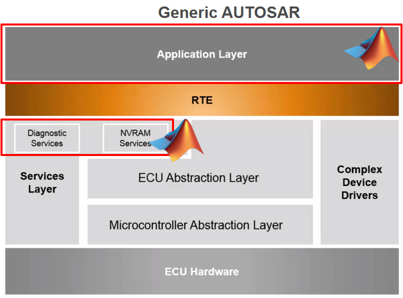

Currently, MathWorks is providing a solution Embedded Coder Support Package for AUTOSAR Standard - File Exchange - MATLAB Central that covers the Application Layer and some components within the Services Layer as shown below highlighted in red
For some of the users this kind of approach would be good enough. They can use Model-Based Design to create AUTOSAR compliant applications (App Layer) and may use PIL just to test the applications on the NXP hardware.
The missing link for a complete AUTOSAR solution in MATLAB/Simulink is: how to support ECU & MCU Layers ?

My understanding is MATLAB supports 2 development flows that are applicable only for Application Layer.
  • Top-Down approach where you can import existing ARXML into Simulink to create Simulink Models based on software components created with AUTOSAR Authoring Tools
  • Bottom-up approach where you start from Simulink models and then export the ARXML descriptions and C code to be used in the AUTOSAR environment.
But, both approaches are only applicable to the Application Layer. Am i wrong ?
