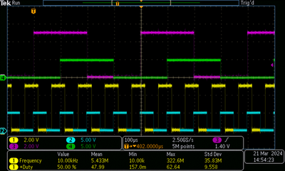

What I see, instead, is that the trigger occurs every two PWM cycles, as if for any period only one trigger was asserted. But actually, as you can see in following picture, I set the PWM outputs in order to have a phase shift between them, in order to be sure not the triggers to be asserted at the same time (I know that, if it would happen, only the trigger with major priority is served):
Yellow waveform: PWM #1
Green waveform: Trigger #1 spycode (toggle on ADC conversion complete isr callback)
Light blue waveform: PWM #2
Purple waveform: Trigger #2 spycode (toggle on ADC conversion complete isr callback)

The Phase Shift setting of the PwmChannel_1 reflects indeed in the output signal that you are observing on the oscilloscope, but it has no impact on the signal passed as a trigger source to the BCTU. Hence, even if the rising edge of the PwmChannel_1 is no longer aligned with the one of PwmChannel_0, the trigger signals sent by eMIOS to BCTU will be asserted at the same time.

By performing this test, you will notice that for the phase shifted PWM signal, the SPY signal will not toggle on the PWM signal rising edge, compared to what happens when you analyze the same scenario when performing the ADC conversion triggered by the non shifted PWM signal. Given this behavior, at each rising edge of the PWM signal which is not shifted (PwmChannel_0 in case of this configuration), you could notice that the active trigger will convert its corresponding ADC channel. Since you are enabling/disabling each trigger in the ADC groups notifications, you could see that they will perform alternatively.
Now, for the behavior that you would like to achieve, you could shift the Trigger signal that the PWM channel is sending to BCTU, so that they are not asserted in the same time. You could do that using the Trigger option in the S32 Configuration Tool - I have set it to 5000 ticks to match the signal displayed on the oscilloscope.
With these setting in place, when running the model on target, I am obtaining the following behavior:
At each PWM signal rising edge, its corresponding trigger is asserted, action which starts the ADC conversion on the specific channel and toggles the corresponding SPY signal used inside the ADC group notification.
  • PwmChannel_0 (PTA1) sends a trigger to BCTU at its rising edge which subsequently triggers Group0. Inside Group0 notification PTA12 (SPY1 signal) is toggled.
  • PwmChannel_1 (PTA0) sends a trigger to BCTU at its rising edge which subsequently triggers Group1. Inside Group1 notification PTB12 (SPY2 signal) is toggled.
The time difference between the PWM rising edge and the SPY signal toggle is caused by the overhead introduced by the functions executed between the moment when the trigger was asserted and the time when the Dio_WriteChannel function was called.
To minimize this time and obtain more accurate results, I would recommend you to perform the SPY signal toggling as the first action inside the ADC groups notification. For this, you could set the Dio block Priority to 1, and increase it for the others, keeping the order in which they should be executed. Please note that this will not remove this delta time completely, since other functions are also performed inside the drivers between these two actions (the callback is called from inside the ISR function associated to the interrupt, and several operations are performed before executing this callback as well).
Indeed, in this configuration, you can't use the Adc_EnableHardwareTrigger function to enable both triggers, since a second call of the function will not complete successfully - the group for which the function was first called will prevent another group to have its trigger enabled (you could see that inside the Adc_EnableHardwareTrigger function implementation). Hence, if you would like to have both triggers enabled at the same time, you could try using separate ADC instances (2 different instances for the 2 different channels being triggered by different PWM signals) or, as you have already mentioned, use the BCTU Control Mode. Please note that in BCTU Control mode you could also start software conversions using the Adc_CtuStartConversion function. As a reference to this, you could check the s32k3xx_adc_bctu_ebt example delivered inside the toolbox.

Hi @Irina_Costachescu ,
as mentioned also in other post about DMA issue, absolutely clear and detailed explanation, I understand now the behavior and it's clear the trigger setup to be done for the implementation I would like to have.
I tested your solution and works now as I'm expecting.
