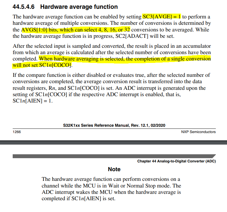

The best answer to the question "How does the ADC hardware averaging works" can be found in the Reference Manual from here https://www.nxp.com/webapp/Download?colCode=S32K1XXRM , the ADC chapter.

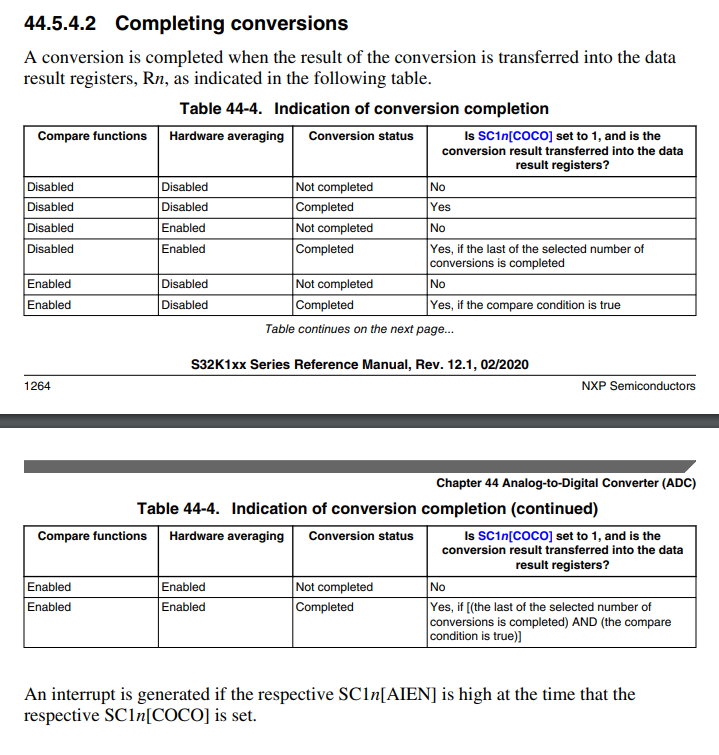

Now, all the toolbox does by enabling the HW ADC and samples to average checkboxes in the config block is to set the AVGE bit and the AVGS1 & AVGS0 bits. From what I've read, once you triggered a conversion, the hardware will perform as many conversions as selected [4, 8, 16, 32], and when it finishes the selected number, the averaging takes place. Once the average is computed, it will trigger the conversion complete interrupt. So, I don't think that the hw averaging takes the sample time into consideration at all.

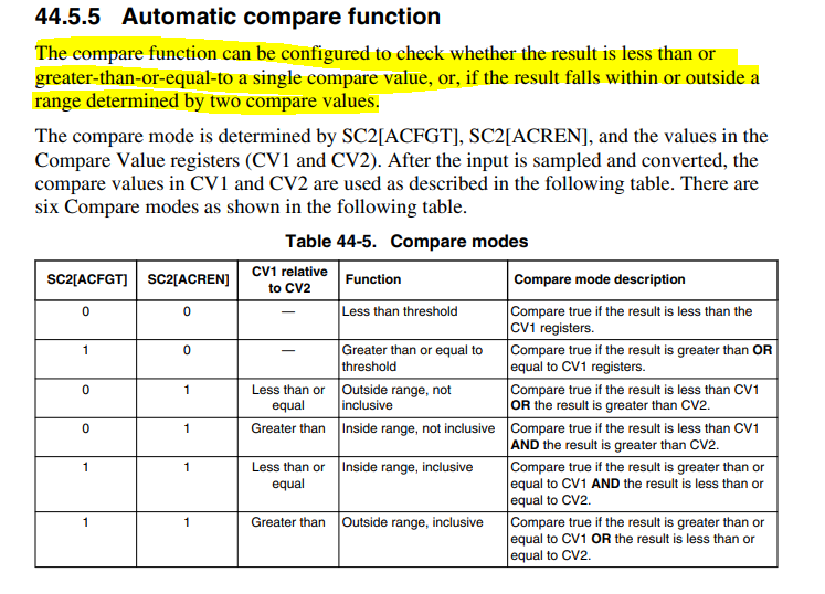

Reading your explanations, reminded me of another hardware functionality: the Automatic compare function, which we also support in the configuration block. And what is nice about it is that the ADC can be set to provide the conversion result only if some threshold conditions are fulfilled. Please have a look at the following screenshots from the Reference Manual.
So I recommend you read the ADC functional description (Chapter 44.5 from the Reference Manual) and maybe my idea of taking into consideration the usage of the ADC automatic compare function may do your task easier. The only question remains how to measure those 40ms of above threshold time, but I think we can figure it out :smileygrin:.

mariuslucianandrei to the rescue again, thank you.  I’ve read that section of the reference manual before but sadly did not make the right connection in my brain until you highlighted the lines.  I still had to read the line twice to make sure I understood it correctly.  I was mostly sure this was how the averaging worked but wanted to double-check so that I didn’t have major issues later.
As for the hardware compare, I was aware of this and planned to use it for one portion of my design but I'm needing to make multiple comparisons simultaneously so I'm trying to do that in software.
